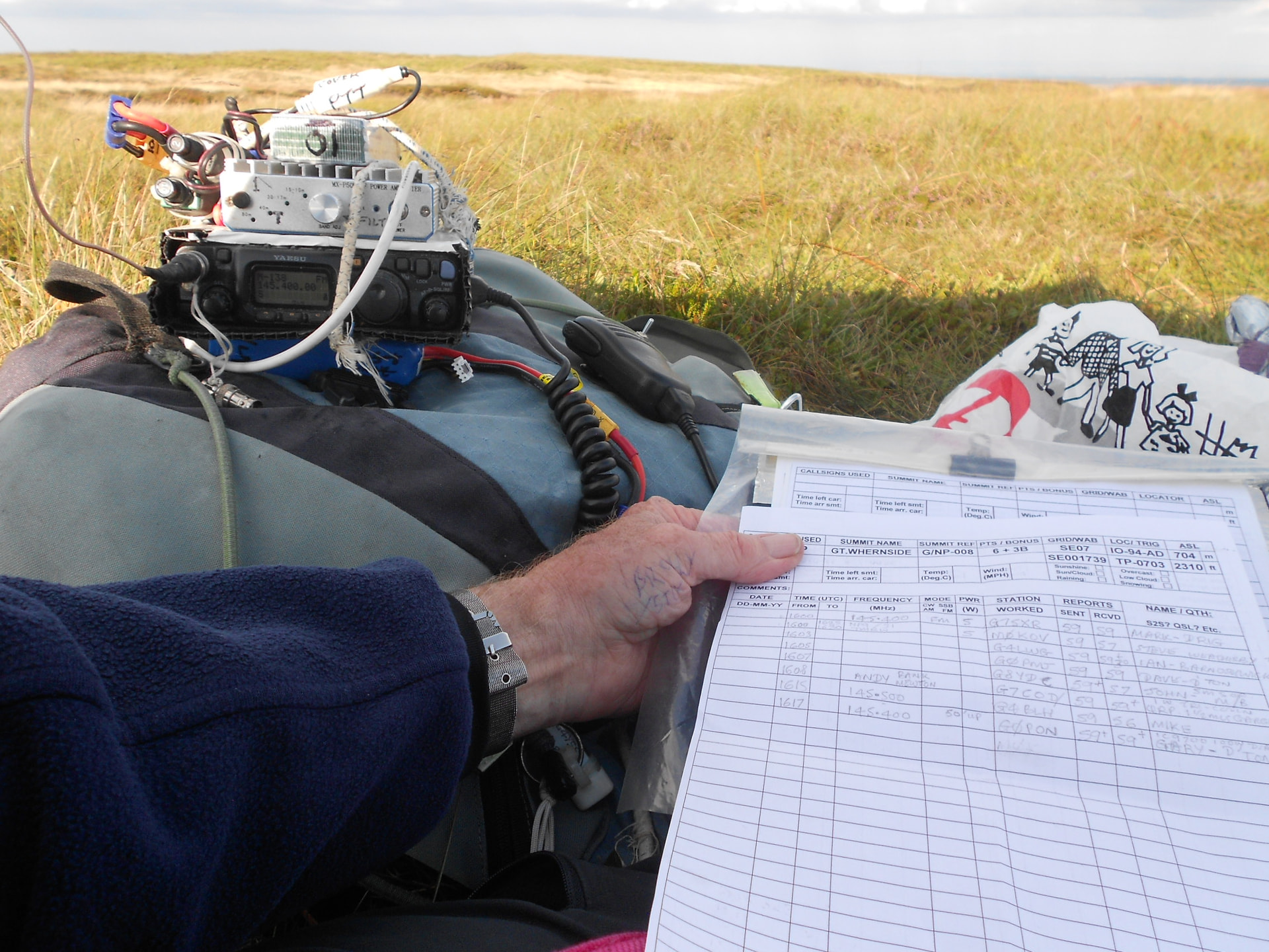

The inv-vee dipole was set up parallel with the fence on its east side and 140m NE of the summit cairn. Two fence posts were employed for tying off. I opened the broken brolly and fixed it in the fence as a windbreak should it decide to rain, which it didn’t. The fence made a half decent back rest.

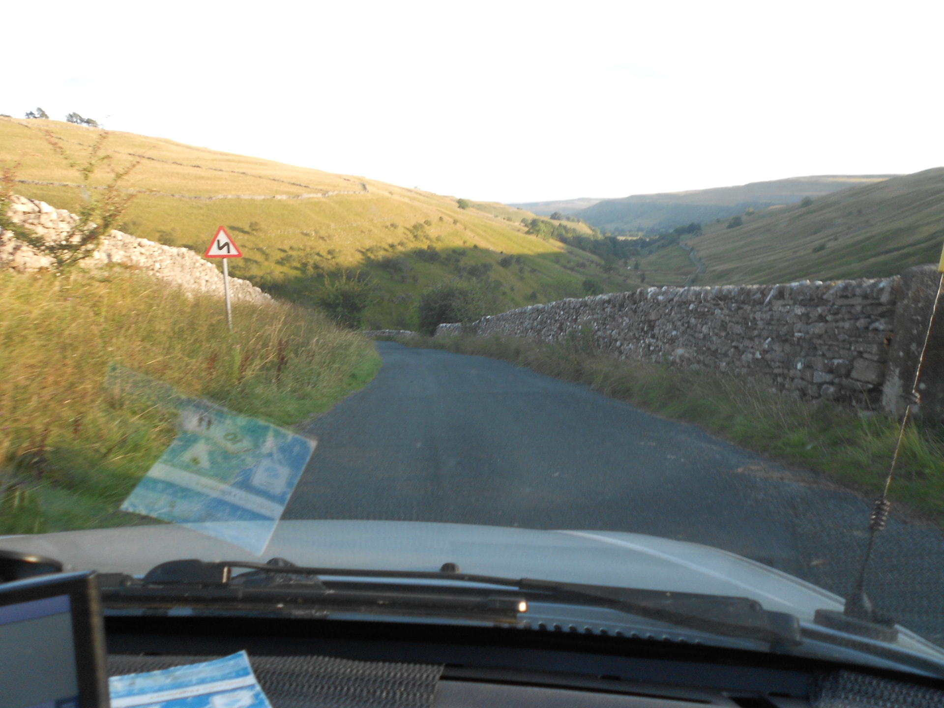

Just for a change I routed via Grassington, Pateley Bridge, Ripon, A168 and up Sutton Bank on the A170. Driving cross-country in this part of England is tedious so despite very light traffic the 83 mile journey took from 19:00 to 21:14.

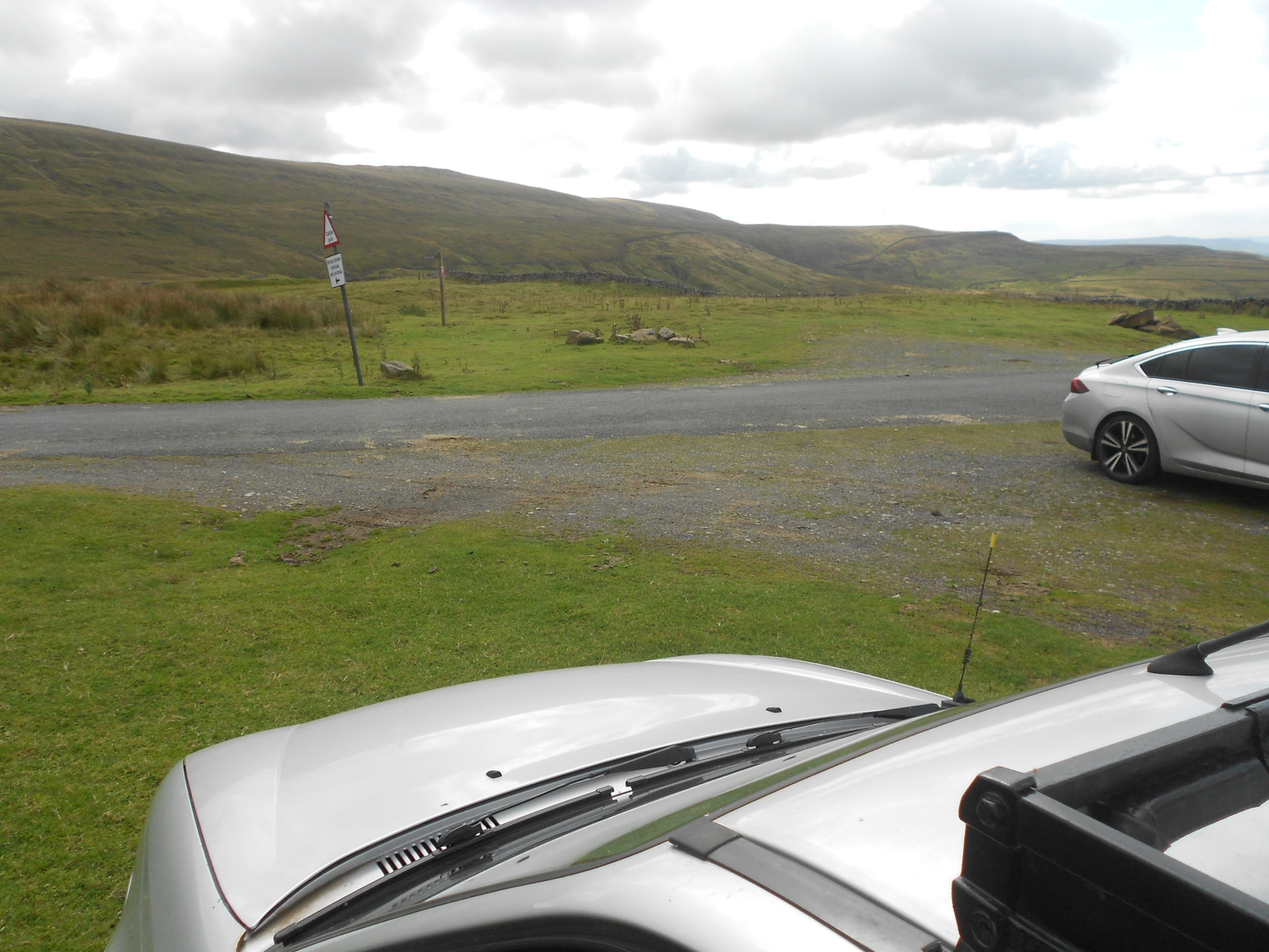

Above: NP8 Great Whernside from the parking place

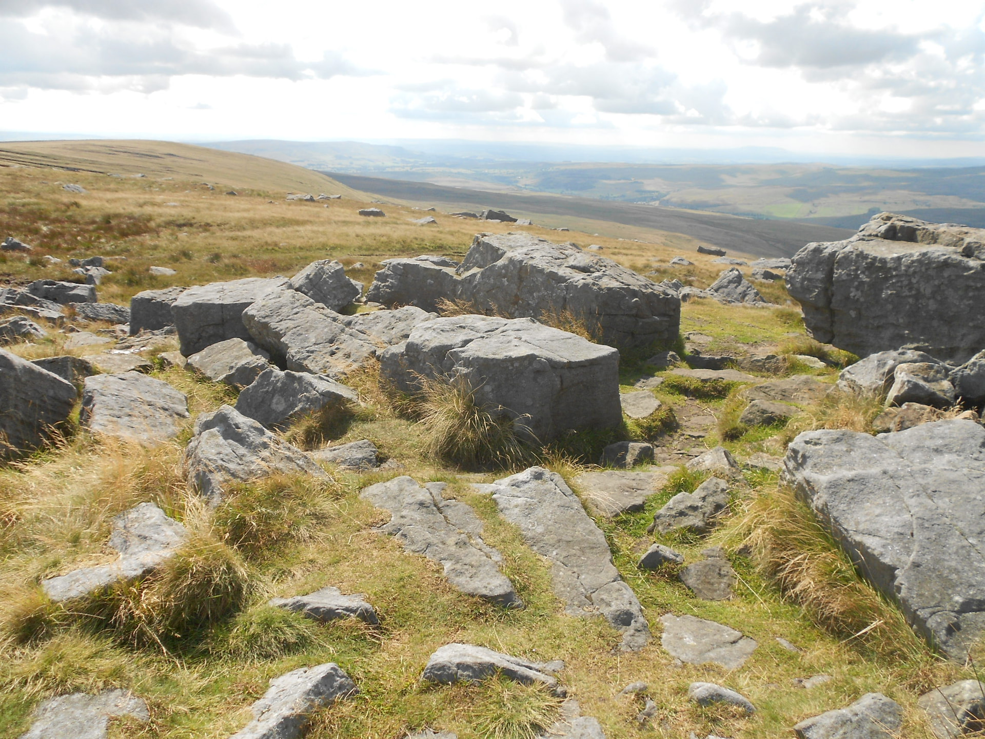

Above: Summit cairn on arrival and trig TP-0703 just before leaving

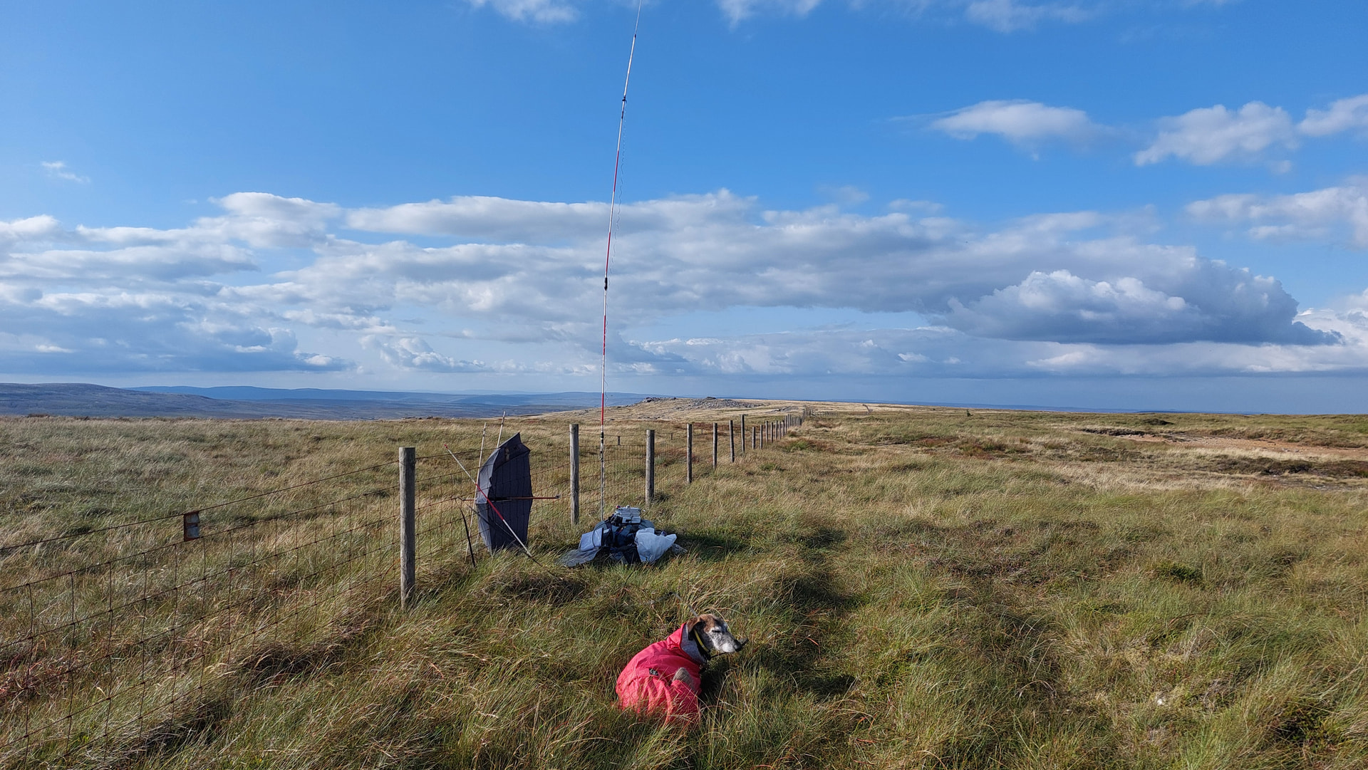

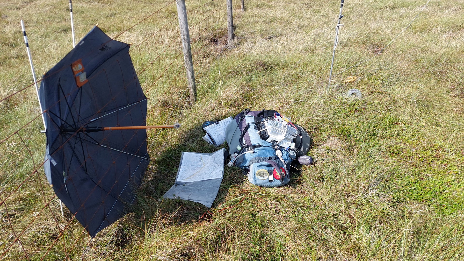

Above: The QTH with Finn & the broken brolly

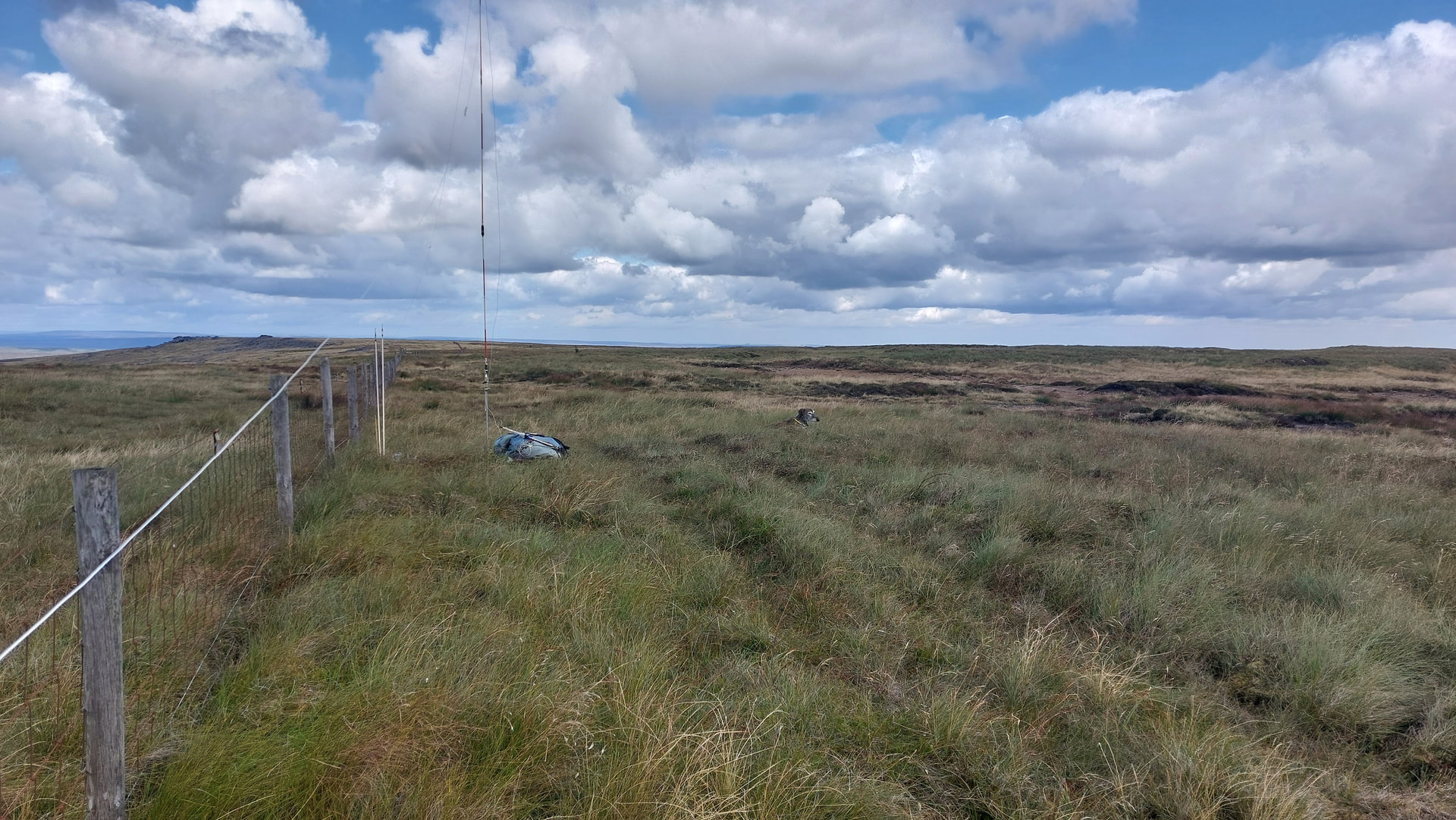

Above: 40m-20m dipole on 4-section/ 5m mast

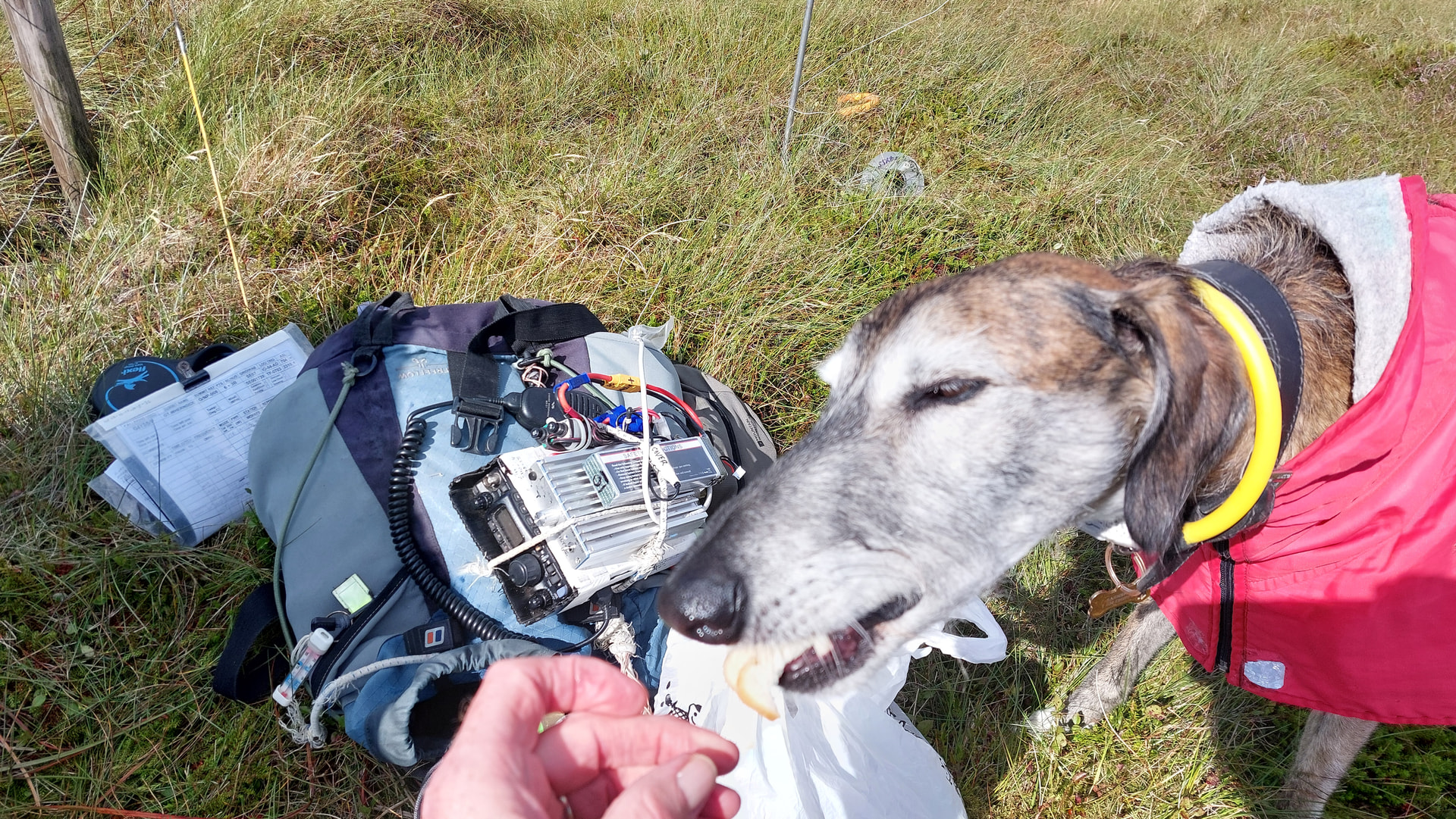

Above: A late lunch. Sharing my sandwich

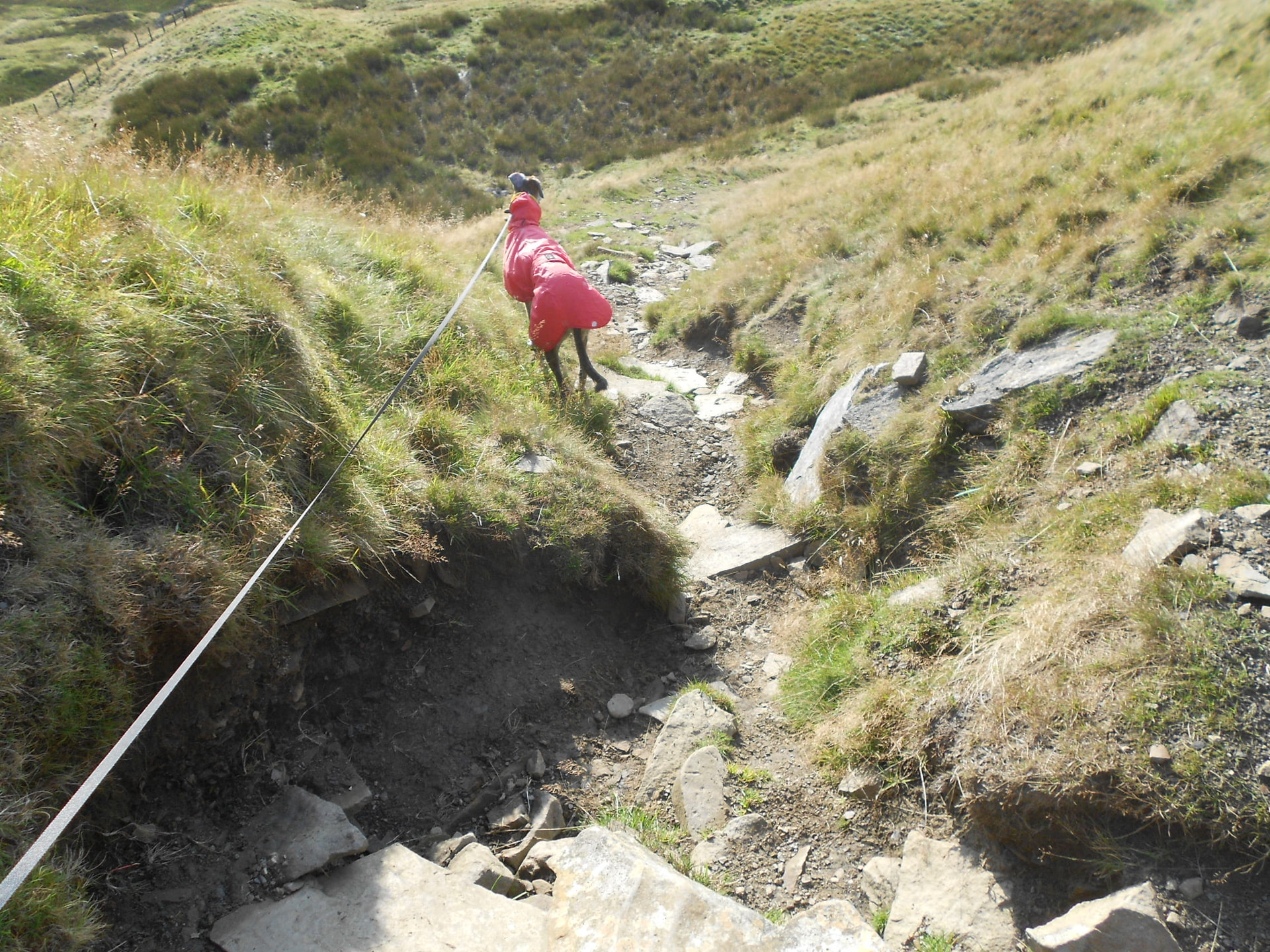

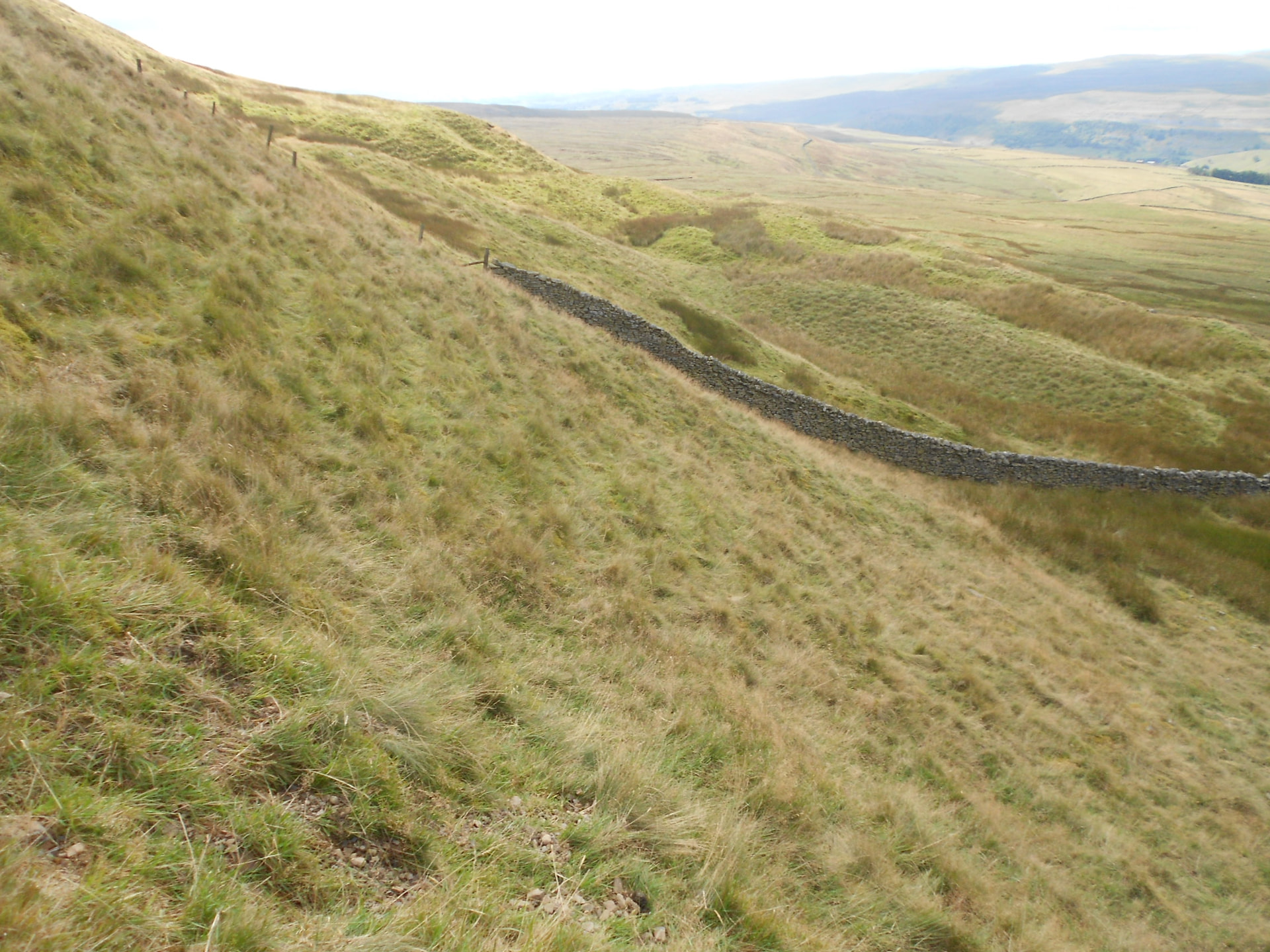

Above: Careful here. Negotiating the steep gully
