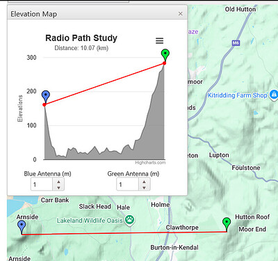

I’m free tomorrow at noon (BST) so I can go to A.K. for a 23cm FM QSO with you. Being 10km line-of-sight due west of you should made for an easy contact if I can find a take-off to the east not obliterated by the trees.

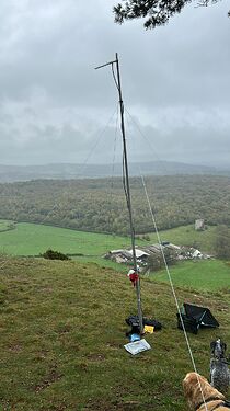

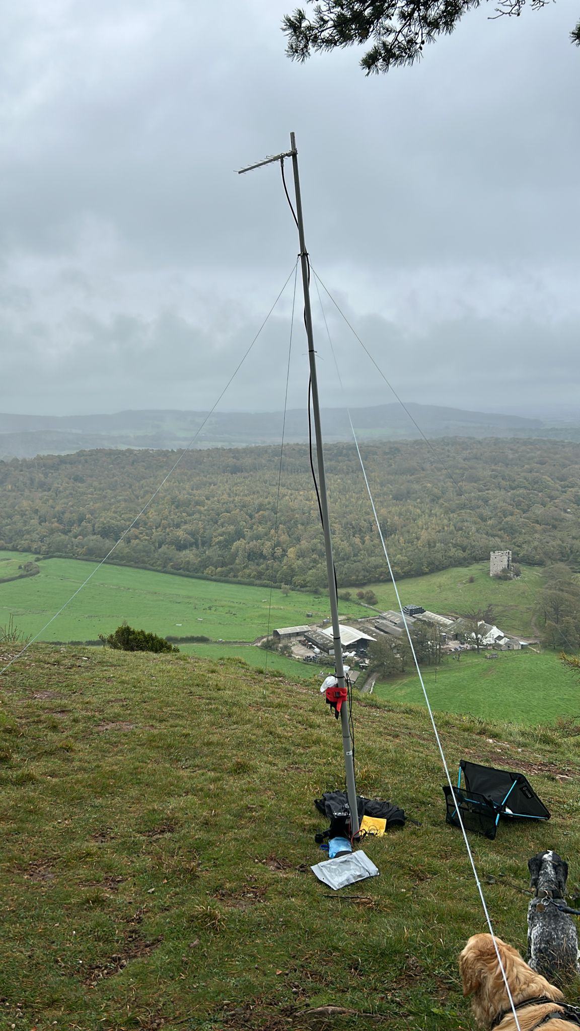

So, I’ll do an activation so we can have a 23cm FM S2S and I hope others will be around for 23cm SSB and CW. I’ll use a horizontally-polarized 8-element Yagi on a 4m pole. I’ll probably monitor 145.500 FM in case someone wants me to change the Yagi bearing.

Thanks to both Ian and Andy for S2S on 2m FM. Despite hills in the way it was 55 both ways to Andy on G/LD-058 and around 57 to Ian on G/LD-052. So you can make contacts even when it shouldn’t be possible. The 2m antenna wasn’t even as high as normal - I had bungeed my 4m pole to the fence and put the flowerpot on top of that so that I could use the 6m pole for HF.

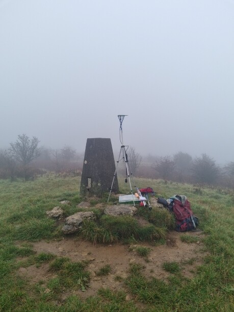

Parked at the quarry and chose the middle path. I wish I had chosen the right hand path now. The leaves in the wooded area had obscured any paths, so I just headed uphill with the idea of figuring it out once I was out of the wooded area. Slogged upwards through dampness and bracken until I found a wall and further up another wall with a sign saying “Hutton Rood Crags - SSSI”. I must be on the right track …. nope. Now in the mist and visibility being around 10m to 20m I navigated using the aprs tracker and a map and found I was too far to the east. Cutting across west (more dampness) to a better track, I followed this until it started going downhill . That was odd. Checked the map, I was too far north. Turned around and went south. Once again , after a short while, it started going downhill. I had walked right past the summit trig point (along a parallel path I presume). After 1.5 hours of trudging, stopping to check the maps I finally found the trig point and setup for 23cm (picture below). 1w from an Alinco handheld into a pcb log periodic.
Only 1 qso with Andy G8CPZ on Arnside Knott. With the back and forth I had lost all sense of direction so I had no idea where I was pointing. Turned out that Andy was 59 on the back of the beam.
