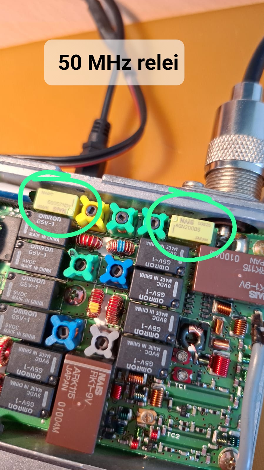

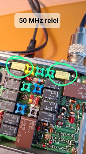

These are two relais for 50MHz preamplifier
