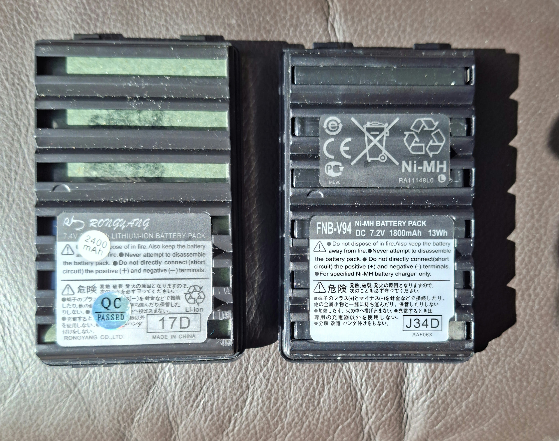

These are two batteries that replaced my old one for the FT270. The one on the left is the latest and came with it’s own charger. Both still working well. Don’t know anything about the one you have a link to.
73 Allan

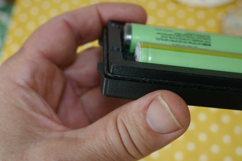

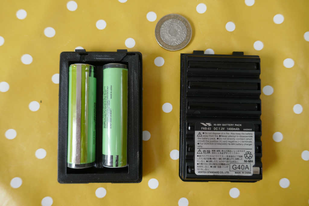

A very nice man in GM/ES 3d printed this for me.
Genuine FNB-83 on right, 3d print + 2x 18650 + UK £2 coin for scale.
The 3d print is sized for 18650 with protection. I have none of those so will make some extra springy battery contacts. I’m waiting for some Nickel strip from a fellow club member.
I have removed the weather-proof gasket from the old FNB-83 to help seal the printed case. Just visible in this photo.
You can’t charge this in the VX-170 but it will be twice the capacity and half the weight.
I would be very interested in the a copy of the code to print one…
This one. There are a few options but these seemed best, even with sizing for protected cells.

Sorry Denis. I can’t find where I bought the batteries from. I don’t think they came from Martyn Lynch and I suspect I bought from E-bay or Amazon. I don’t use anything else.
I can’t find the Lithium-Ion one anywhere (left in the photo) but I found the battery which is on the right of my photo on Amazon when I ran this search ‘FNB-V83 FNB-V94 Ni-MH Battery for Yaesu FT270’. Priced at £27.86. Your existing charger would work with this. There are loads on E-bay below and above that price.
