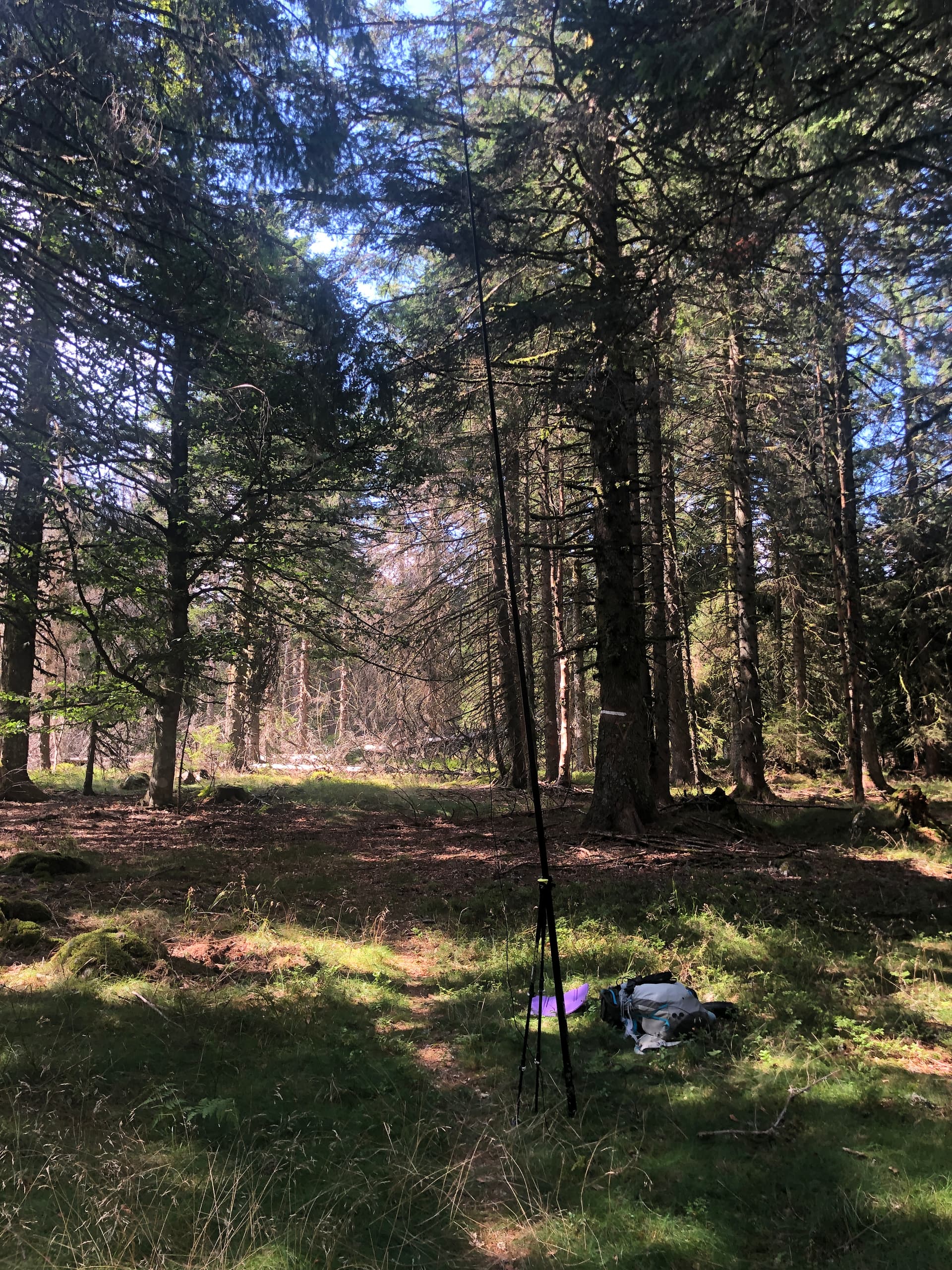

- Many of the summits are in woodland; some have great views, but for many, you are surrounded by trees.
- This makes maintaining a GPS lock problematic at times.
- The ascent for some summits is steep on loose soil with a layer of dead leaves, making walking up as slippery as mud.
- I had many followers of the flying kind. On some summits I had to put on a thin long sleeved hoody to keep the flies off me
- For 80% of the activations, I could use a (summit) post, fallen tree, tree stump or other item to fasten my pole to. On a few occasions I used the Sotabeams Mini Pole Stake Kit. (I never had a deploy any guying rings/guy lines on any of the activations

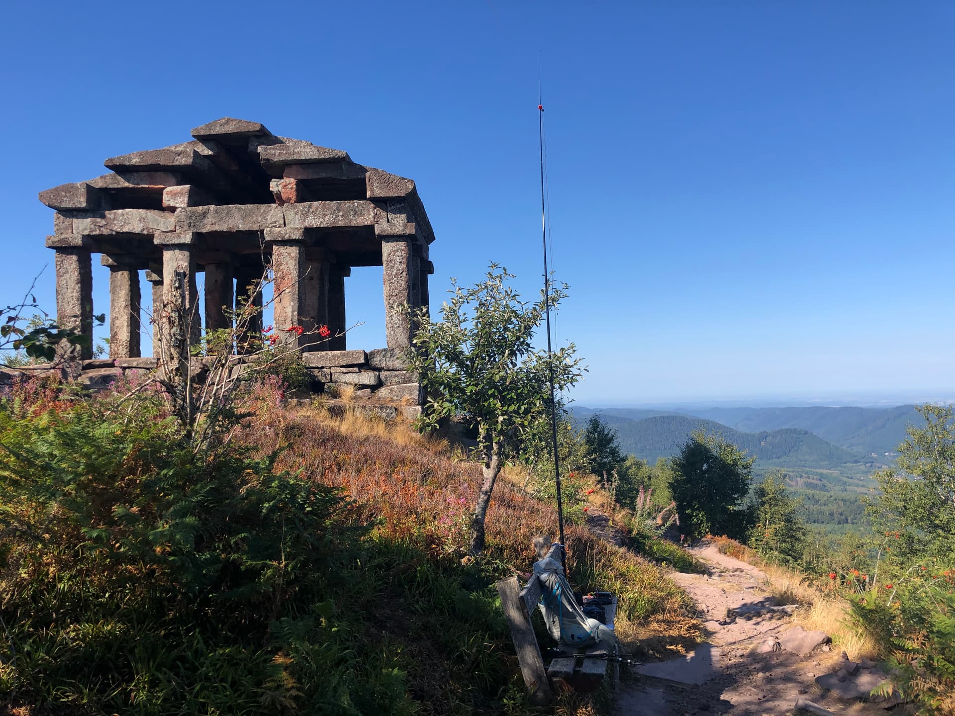

Day 1 (Aug 22): FL/VO-023, FL/VO-090, FL/VO-092, FL/VO-019, FL/VO-069, FL/VO-016
The first 3 summits can be reached from the same parking place. There is not much room, but a bench allows to easy pole fastening. FL/VO-019 is a ‘drive-on’ summit and the blurry photo taken on FL/VO-016 is a result of the huge amount of flies preventing the camera from focussing on the far distance.

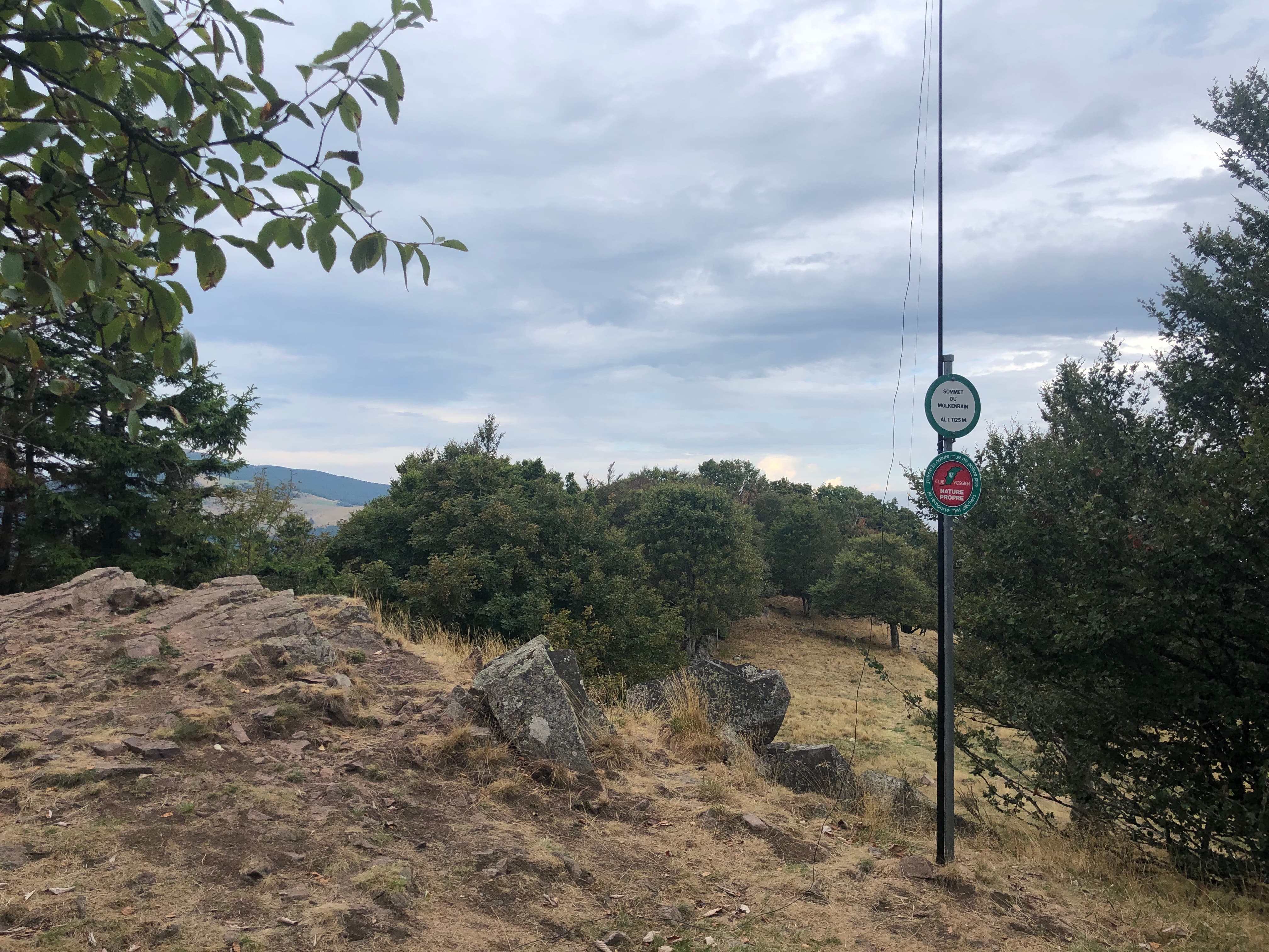

The plastic spacer broke on one of the links of the dipole, so had to perform some repairs. I tried to get closer to the fence at FL/VO-009, but the sign seemed to indicate that either snakes or spikes were present in the undergrowth so decided not to attempt to get to higher ground. Since this location was not in the AZ, I walked back into the open field at higher ground well within the AZ.
