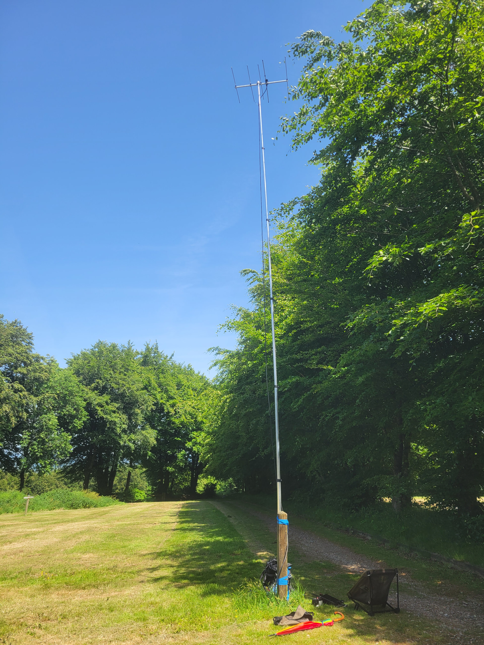

Hi Gerald,
well done! :+1:
Could you please share some information about the pole and the antenna shown in the picture.
Cheers, Peter
Hi,
Definitely not lightweight! It’s OK for “near roadside” type activities. Although I have stretched that a bit and carried it up Moel Famau GW/NW-044.
The mast is an LMA-L 33ft Portable Telescopic Mast
The antenna is a Diamond A144S5R 2M 5 Element Yagi
I also carry the standoff to permit vertical operation.
I have 10m of RG213 heavy duty coax, with the correct plugs, PL259 and N Type, to connect direct to the antenna and my FT-857 and with an N to BNC adaptor to my IC-705.
For RSGB Contests I use the 705 at 10w and 5w for the Backpackers and limit the antenna height.
Today I used the 857 at 40w and all the mast I could use! It worked well. With contacts over 400km.
Definitely a decent equipment! :flexed_biceps::top_hat:THANKS for the information.
