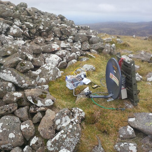

It is also possible to use the QO-100 sat but not for FM. The advantage of QO-100 is there is no time constraint, the sat is there 24/7. Nick G0HIK and myself have had a number of activations (G4VFL = 23 summits) on QO-100. With some alteration in config of the 2.3GHz you can also do S2S.
Here is a picture of my activation on GM/SS-072, 50cm dish + 2W is plenty big enough. Most summit ops I get away with the dish on the ground but sometimes it needs a little elevation to about 0.5 -1m AGL.
