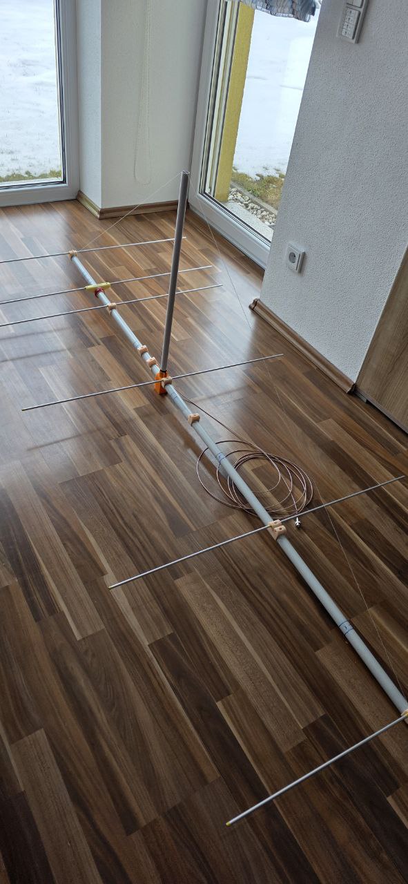

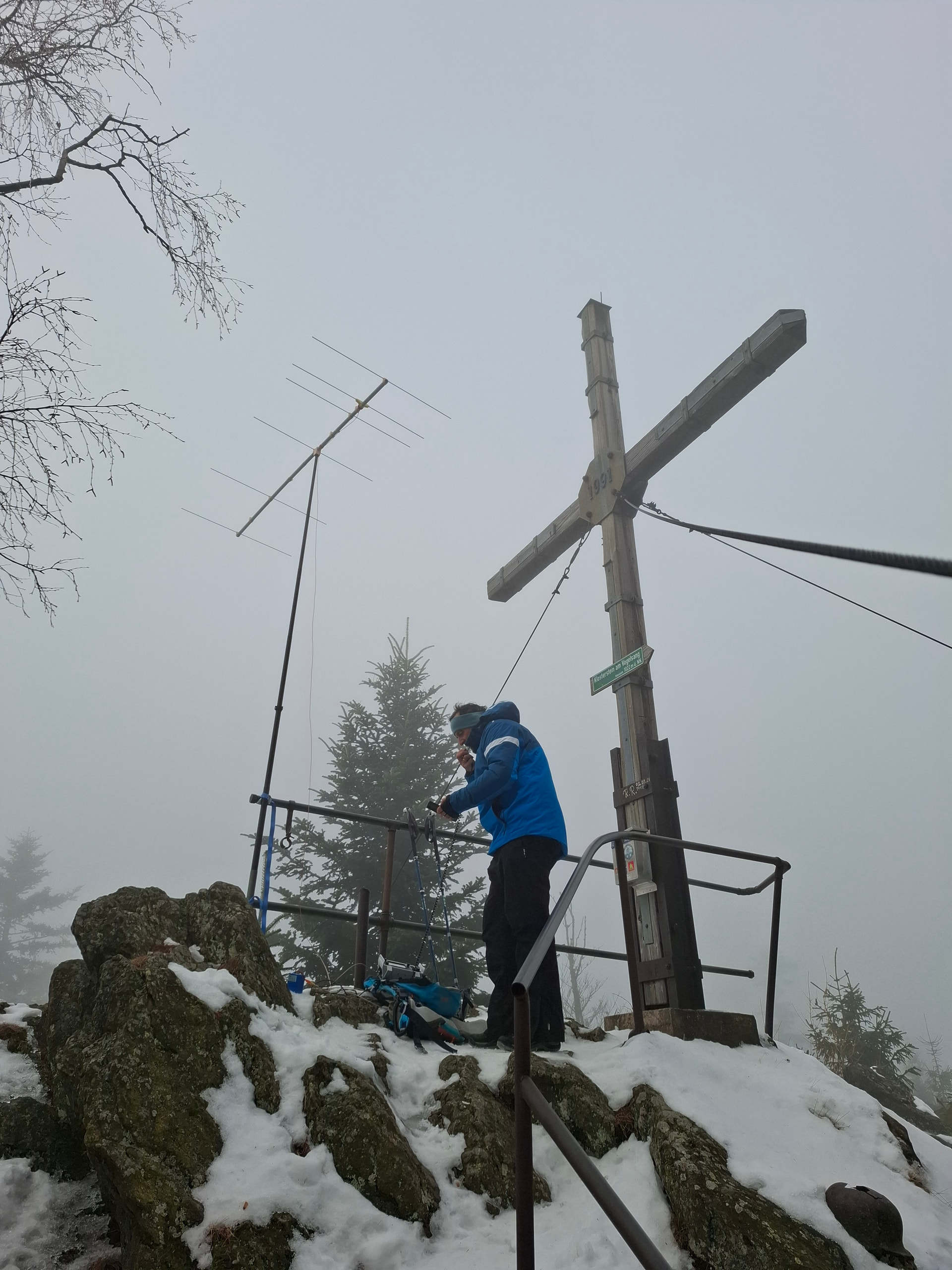

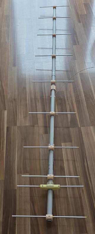

The first tests on 2 m SSB were still done using a 4-element log-periodic antenna, which had generally proven itself well for portable use. However, after an interesting conversation with Joe OE5JFE, I decided to take a different approach. The choice fell on a lightweight 6-element DK7ZB Yagi, which offers very good characteristics especially for portable operation.

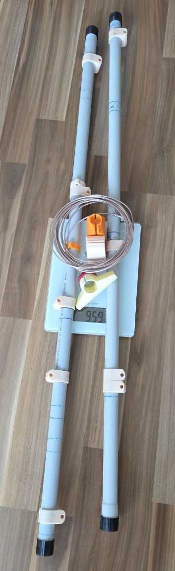

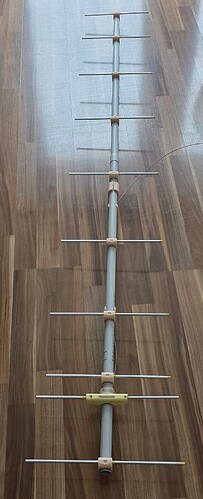

Based on the well-known DK7ZB design, I slightly modified the layout and incorporated my selfdesigned 3D-printed parts. This resulted in my own version made from two 25 mm electrical installation tubes, which can be fully disassembled into 1 meter segments. Practical usability for SOTA was particularly important to me. The boom can be used for both a 2 m and a 70 cm Yagi using different element lenght and positions for maximum gain.
6-element DK7ZB Yagi, folded for transport
The result is an extremely lightweight and compact antenna with a total weight of under 1 kg and a packed length of only 103 cm – ideal for a backpack and also for longer, more demanding tours. In practice, this antenna solution has proven to be very robust and high-performing.

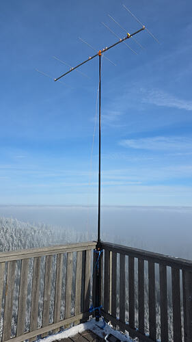

Activity Day on January 18, 2026 on OE/OO-135
The start of the new year was therefore extremely pleasing. In the whole month of January 2026 I was able to complete a total of 32 SOTA activations, most of them on 2 m SSB. Altogether, nearly 500 challenge-relevant QSOs were made, covering over total of more then 40,000 km. The activations were not only great fun for me – the motivation and activity of the chasers were clearly noticeable as well. Many of my usual chasers as well as new callsigns (from the contesting scene) found their way into the log.
A special highlight was the 521 km QRB with 9A0V on January 18, 2026, achieved during the January VHF/UHF/SHF activity day. Contacts like this impressively demonstrate the potential of the 2-meter band – especially in combination with portable SOTA activations and SSB operation even from low summits.

Nice yagi. What’s the design/layout of the driven element part?
It`s a remix of 6-El.-2m-Yagi , details here PVC-Yagis

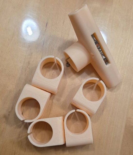

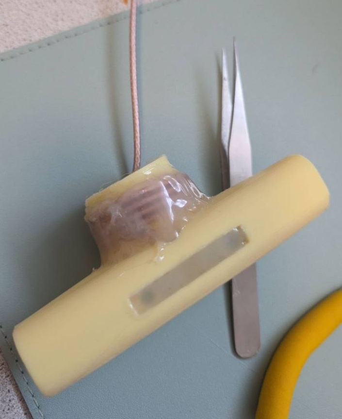

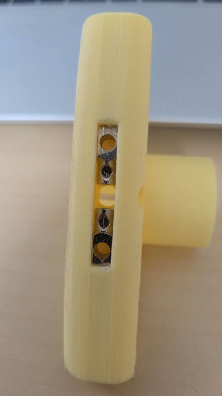

I designed a 3D-PLA Part with 2 banana plug, to mount the 6mm alu tubes.
I can connect the 2m driven parts or the 70cm
Thanks for the close ups.
Very interesting, and the tubes stay in fine with the banana plugs (sockets?)?
Yes, the fitting is verry good, the alu-tube has a outer diamater of 6mm with 1mm wall thickness, so the banans plugs fits nearly perfect. It`s also a combination of fitting with the 3D PLA-Part

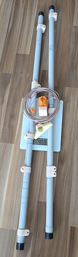

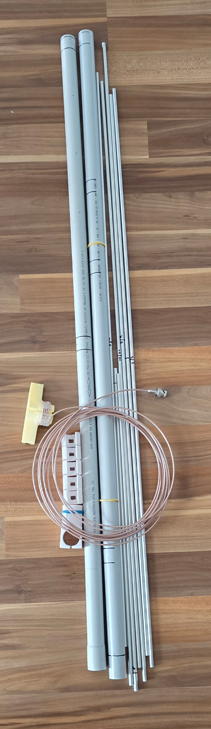

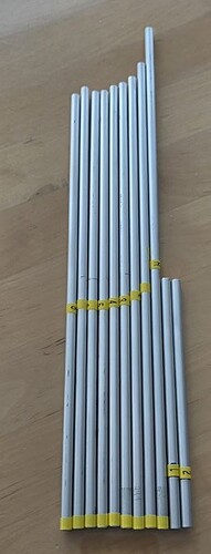

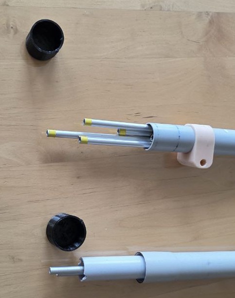

here you can see the whole 70cm + 2m Antenna, the alu-tubes where placed inside the 25mm electrical installation pipe covered with a TPU closure. The length is about 104cm an the weight below 1kg.
The smaler 20mm electrical installation pipe is used for better tension. See the last image.
This antenna-design is still in processing :slight_smile: But i think i did the last 20 activations with this design.

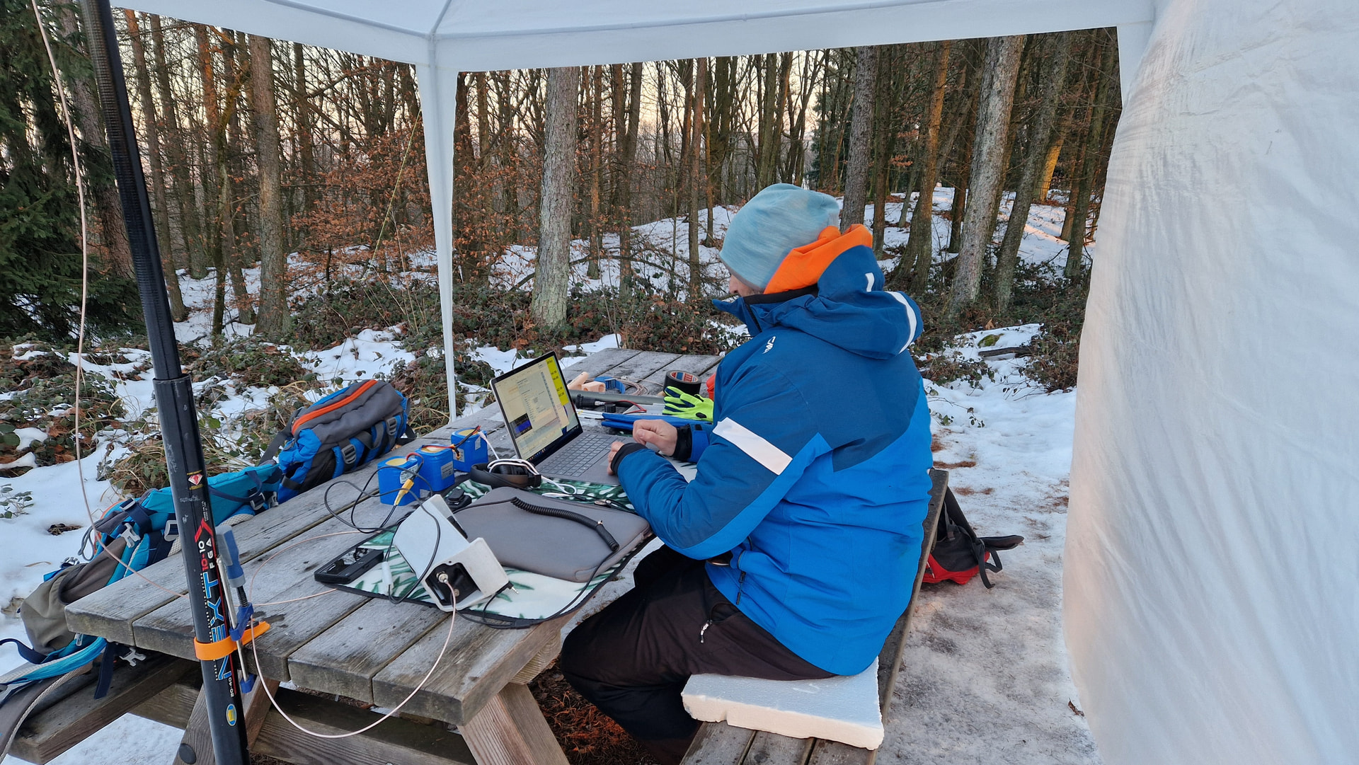

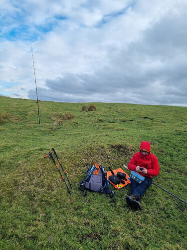

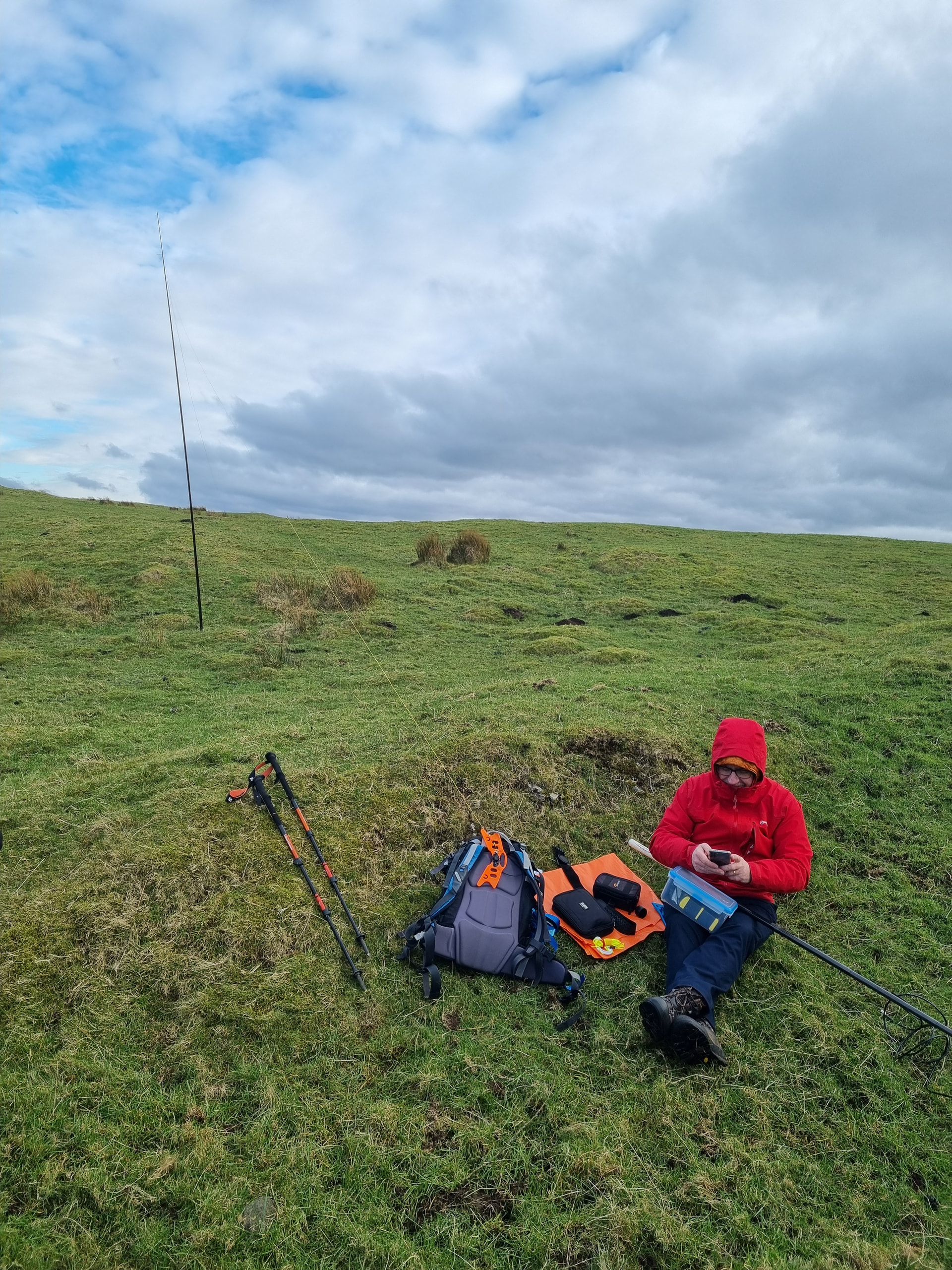

Nice!!! I too am enjoying using 2m ssb. But I’m far too lazy to spend time turning a yagi… I’m also too lazy to change polarisation too. :slight_smile:
So I just use my usual Slim G roll up antenna hung from the top of a pole. Omni and vertical. Yes… I know, SSB should be horizontal… but I’ve actually spoken to a lot of operators on their normal FM set up of a vertical “white stick”.
Looking at your photo, our operating positions have been somewhat different! I’m usually sat on the ground on a windy damp hill… you seem to have a much more pleasant set up!
Sat on GM/SS-260 on 03FEB26. Cold and windy (this became a “wear 5 layers” day)! Set up shows HF antenna, the 2m antenna is on the pole on the ground in laid down in front of me.
Your results speak volumes though! I’ve only got 8,500km in 15 activations.

Meanwhile I had the opportunity to test your antenna personally when we activated DM/BM-010 and DM/BM-019 together on Friday and I was convinced right away. Despite the thick fog it was a great trip together and I am really looking forward to build the antenna now! :blush:
