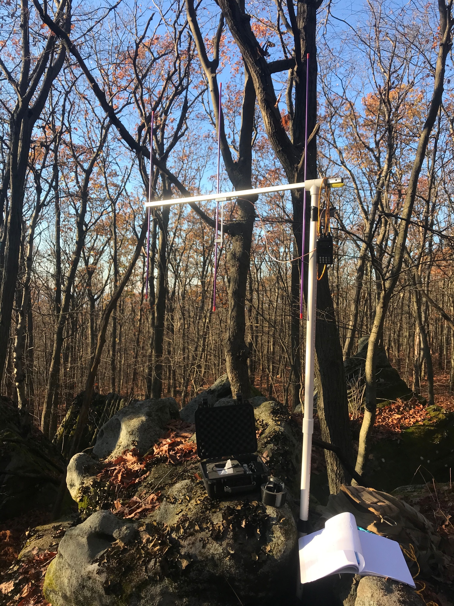

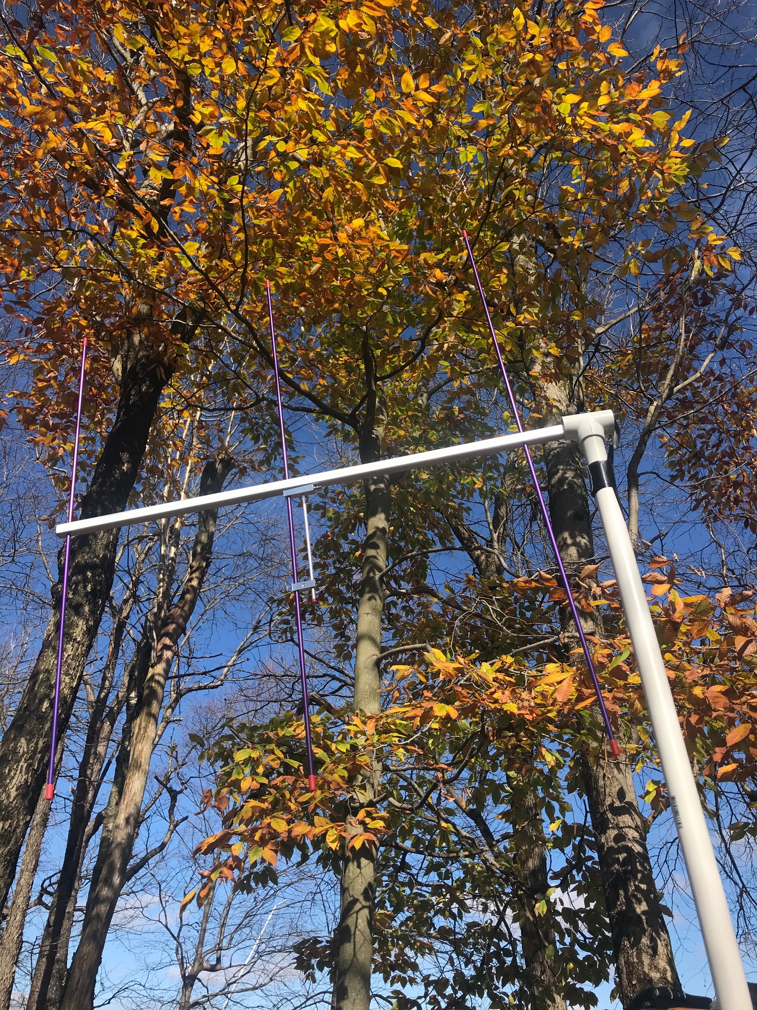

After two failed attempts from the lower, flat topped summits of Pennsylvania (using a setup that worked so well from the high Rocky Mountain peaks) I debated about using a more powerful rig or purchasing an amp for my HT, also suggested here in the reflector was a Yagi. I decided to go the Yagi route first.
Here is my preliminary setup on the summit of Seven Springs Mountain. FT60R HT, Arrow 3 element Yagi and $5 in PCV piping for a support.
I was thrilled that my very first call on simplex was answered with the Yagi pointing toward the populated Pittsburgh metro area! I quickly activated the mountain with great signal reports and excited hams who had not had a VHF SOTA QSO. It seems there was quite a stir on the local repeater about my presence which helped!
