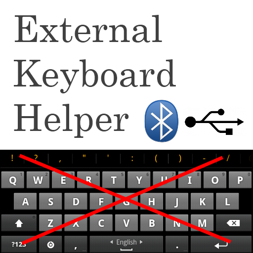

If you do buy a non English layout, you will need a support app, as non English external keyboard support is non built into Android:
I find the above app works fine. It’s best to leave bluetooth on all the time to avoid config problems. The cursor keys allow navigation between dialogue boxes. My only gripe with Portalog is that I can’t get it to run in landscape, and I would like to have the SOTA ref field right under the RST dialogue boxes, so I don’t have to scroll as far for S2S entries. It would also be nice to be able to access the save button with cursor keys and hit return to save, rather than tapping the screen. Apart from that: how did I ever cope without it. I take an Ortlieb map case in case it rains; they can fit an 8 inch tablet comfortably. That said, I have never activated in the rain, so I cannot say for sure it will work ok.

I tried it out yesterday on the Kƶnigskogel and it functioned well. It is slightly smaller than the old keyboard; they have omitted some keys on the far right and integrated them onto the adjacent keys. That’s fine for me, as I rarely use Ƥ and #. The keyboard integrated seamlessly with my Android phone and the External Keyboard Helper app I use:
