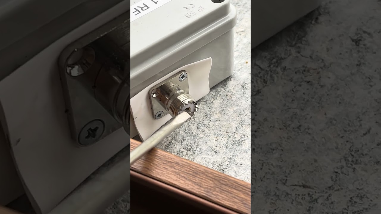

I have not experienced it myself, however I remember watching a YouTube video where an activator had a video of arcing between the pin and collar of a PL259 plug attached to his antenna. I hope you enjoyed Moel Famau (Scouse mountain :joy:)
