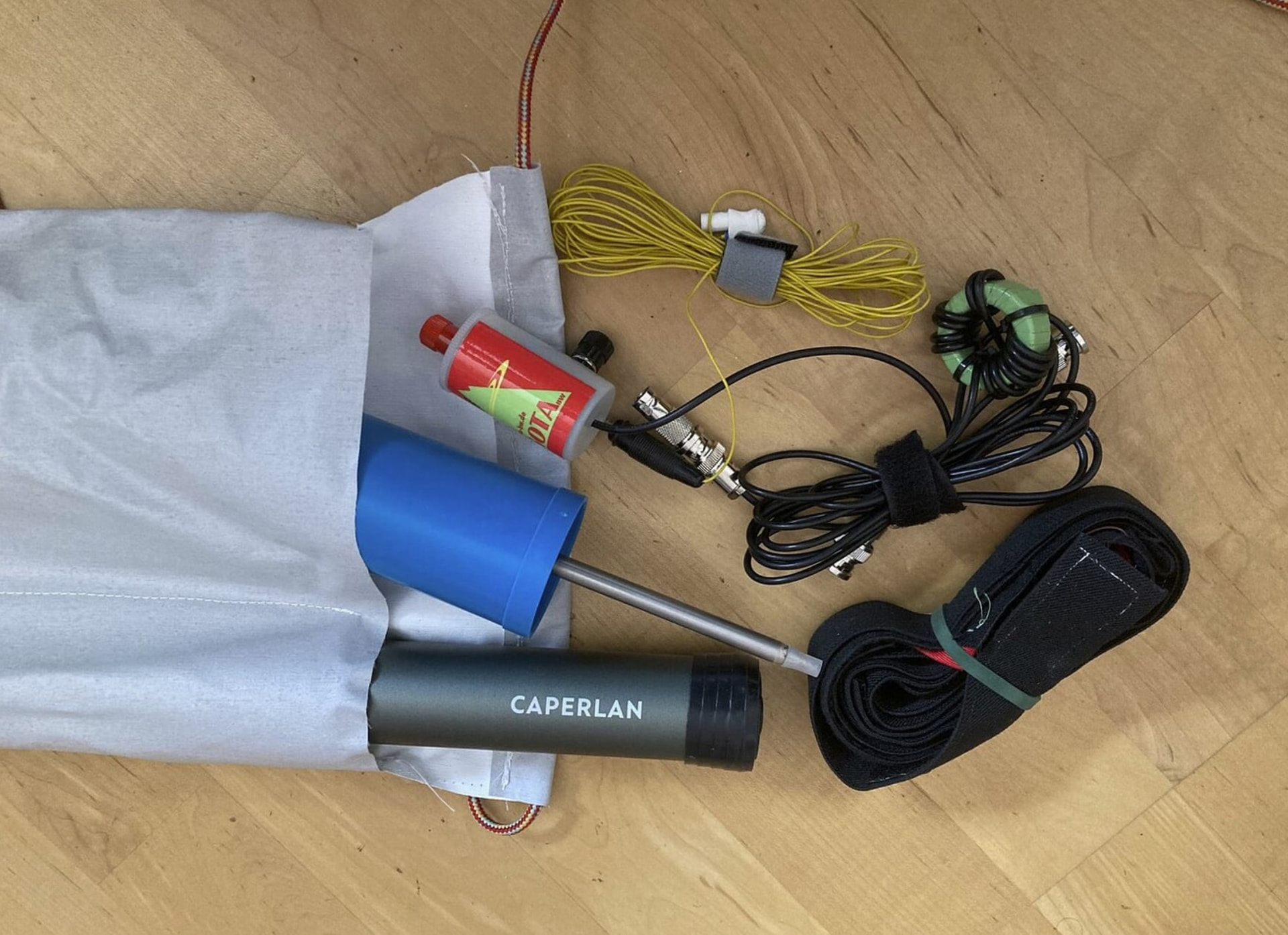

Here’s my suggestion for an alternative:
Decatlon 6m mast (not carbon), 5.80m wire, 1:9 unun, 2m RG 174 (the shielding acts as a counterweight - radials don’t offer a significant advantage) with a choke.
This antenna also works well with a tuner from 20m to 10m. Its flat radiation pattern is advantageous on these bands compared to an end-fed antenna.
When D4 was first activated D4/IB-023, I switched from the end-fed to this antenna at EI/IW-035, and only then did I achieve my first QSO and S2S with D4. Before that, I hadn’t been able to make D4DX. - And on May 2nd, I had an S2S with VA2EO on VE2/QC-078… and the conditions weren’t really great.
If you want to increase the power output, you simply build a more robust unun. :wink:

A home-made AX4 with the AX4-type 2.5m radiator that includes a tuner (!) can easily be put together for a few bucks…. no need to mortgage your house if you can do with a slightly less classy design… QMX antenna - #9 by HB9EBE . Quite impressive performance by the way. And no balun needed.
