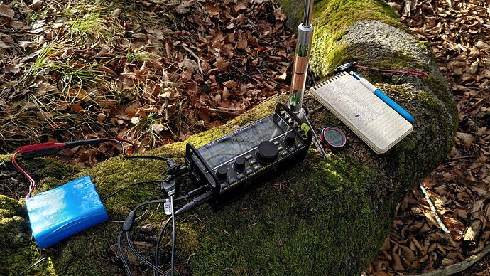

Amazed with the DX I got recently with my KX2 (10W CW) and the AX1 antenna (well known 115cm whip from Elecraft). I haven’t used much the AX1 but I really impressed with the performance :sweat_smile: During those activations I used the tripod adapter and the stock counterpoise.
- 30.10 from OK/OM-001: JH1MXV on 20m
- 06.11 from SP/SS-003: @WX1S and @N4EX both on 17m
The AX1 set, tripod and short feeder fit nicely in this small pouch from Aliexpress:
