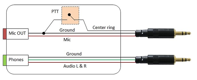

I ran briefly on 145-FM, 7-CW, and then spent almost all the time on 14-SSB to do an extensive testing of phone using an adaptor to use my regular cheap PC headset with the FX-4CR.
On my previous activation I used the stock microphone, but it is too bulky for this little radio.
This time I brought a very simple adaptor for the headset, which worked fine. Audio reports with the headset were fine, they told no distortion nor bad audio on my voice.
I ran middle power set to 9 w from the rig to avoid overloading or RF feedback issues.
At home my voice sounds just similar when monitoring on the shack with the stock mic or with the headset.
