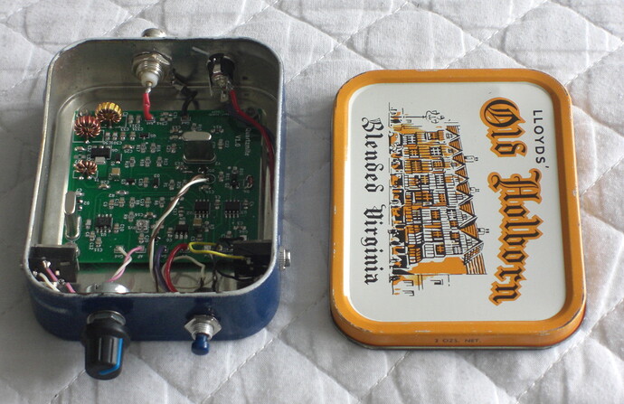

I managed to womble an old Tabacco tin. Thought this was highly appropriate and looks like it will fit perfectly for a 3 cell, 2 or 3 parallel battery using the largest vape batteries 21350, the 1500mAh ones. So a 4.5ah 12.8v battery.
Just waiting for JST and BMS to finish this.
That looks like it would be the ideal power source for one of my Quartzmite radios.
