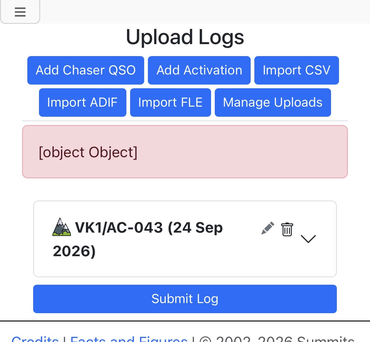

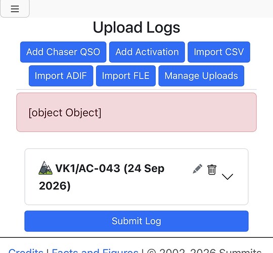

I have put a report in the contacts that Sotawatch 3 is not logging here & comes up with object object in red, I have tried manually and no luck. Mark 2W0JMK having same problem.
Don PLP.

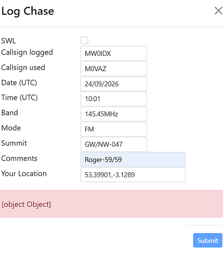

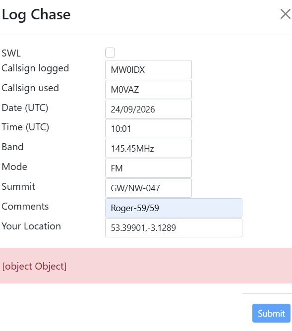

Its not just me then getting the same error [object Object]
Got the same here :face_with_raised_eyebrow:
Here also.

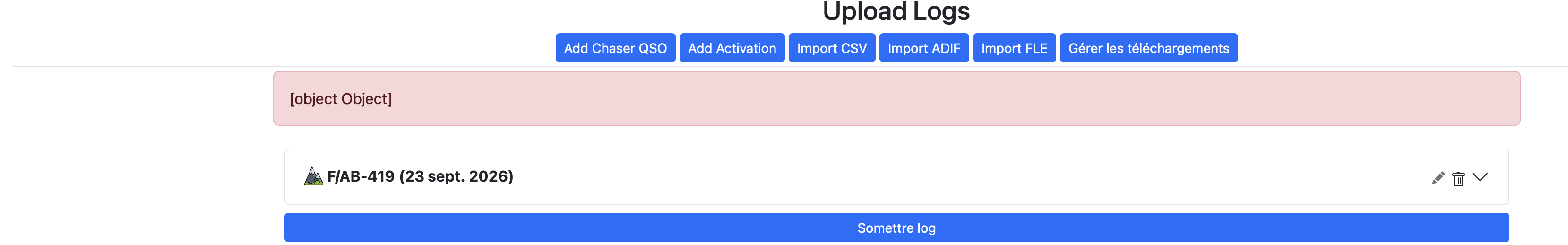

Same here. I also reported this issue via the official MT contact form.
Me too ! Impossible to add activation : (object Object)
