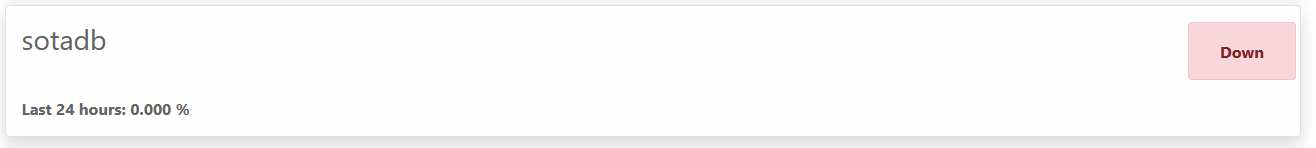

Looking at https://status.sota.org.uk/ the db is completly down since 24 hours… ?
not sure how true that is as I can look at my data.
The database is fine. Looks like an issue with the code that checks the status of the database. Thanks for letting us know.
