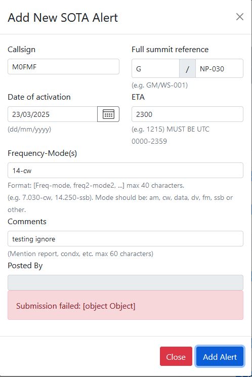

I successfully alerted for G/NP-030 using Sotawatch.

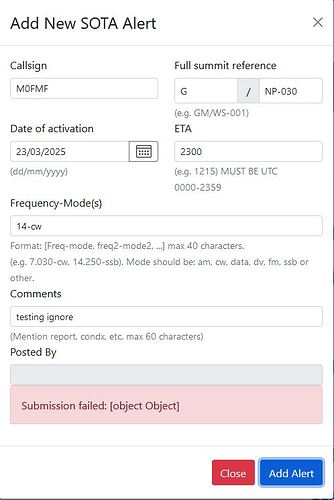

I can’t :frowning: (Or maybe :slight_smile: )
Very strange… I cannot edit your alert even with SuperAdmin power. But I can impersonate you and edit the alert. Wierd. I’ll look in the logs later. Back to winding toroids for now.

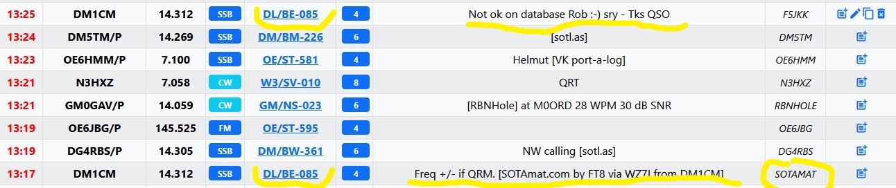

DL/BE-085 has not been valid for 15.5 years :man_facepalming:
Oui je comprends c’est juste pour amener de l’eau au moulin
Adding water to the mill is not adding fuel to the fire

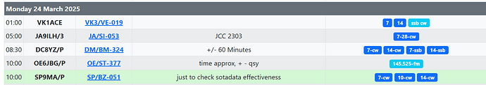

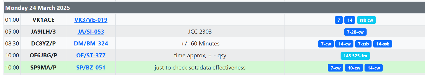

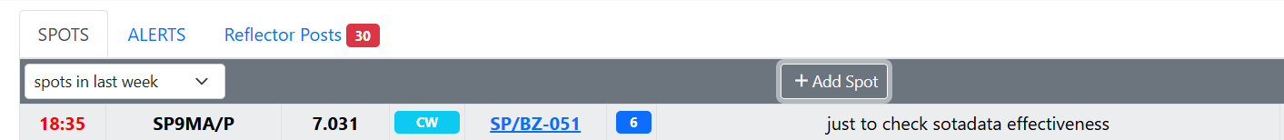

SP/BZ-051 is not valid from August 1st, 2018

SOTAWatch has deliberately vaguer validity checks (for alerts and to a lesser extent spots) due to the presence of wildcard spotting.
