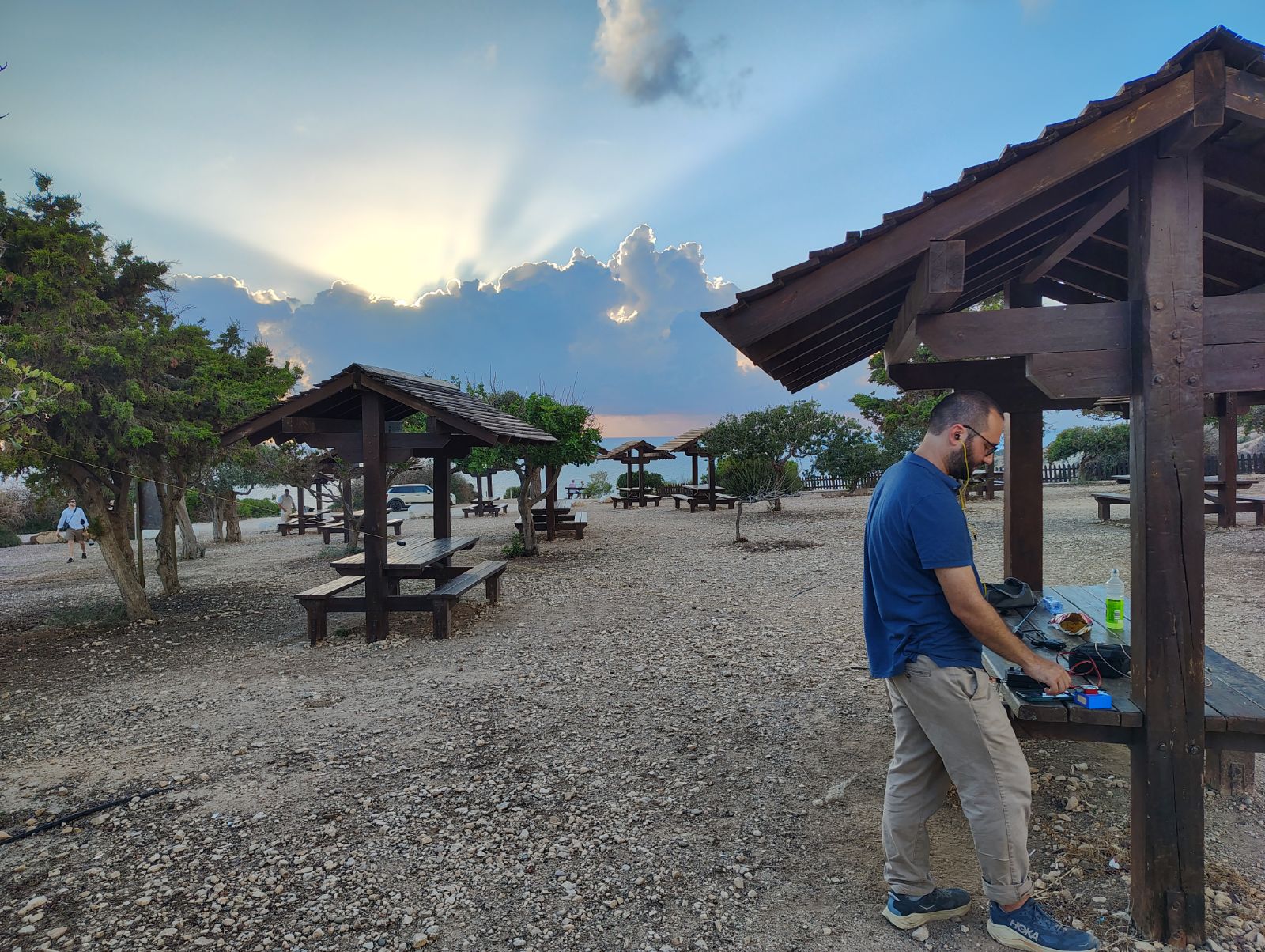

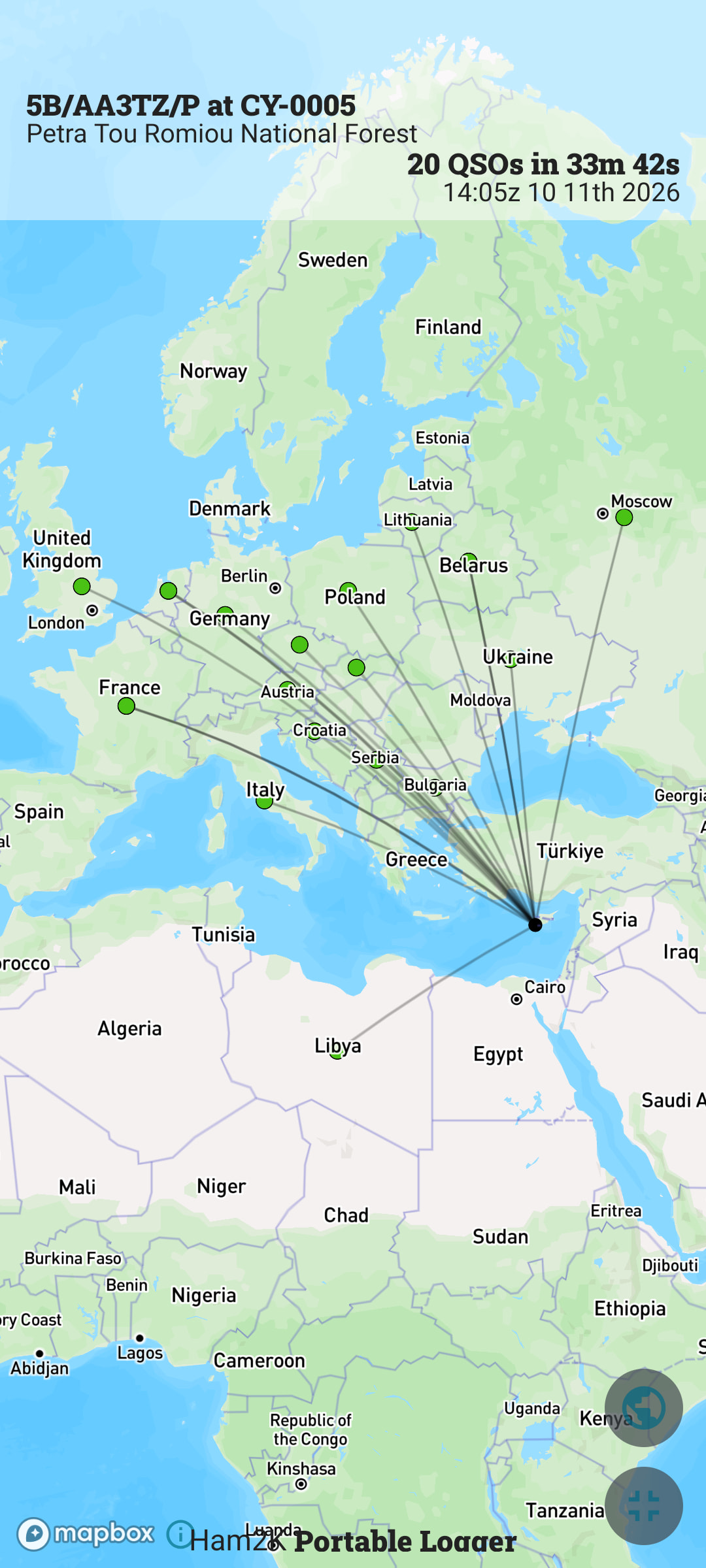

Enjoying my time here. Spending more time doing non-radio things, but I was able to get a POTA activation at petra tou romiou, a lovely site!
I was having serious issues with my KX2’s ATU, and found I had to hold the wire in my hand to get my SWR down to 2.5:1. Weirdly, bypassing the tuner via software settings didn’t really work either. I turned the power down and got a good 20 QSOs one-handed.
Turns out, the solder joints for the wires to the connector from the ATU board to the main board finally failed - all the vibrations from 10 years of use finally did that in. I connected the jumper from the BNC connector directly to the main board (my antenna is resonant anyhow!) and it looks like I’m back in business for the SOTA peaks this Thursday! Looking forward to it, resting a bit easier now that the antenna issues are resolved.
