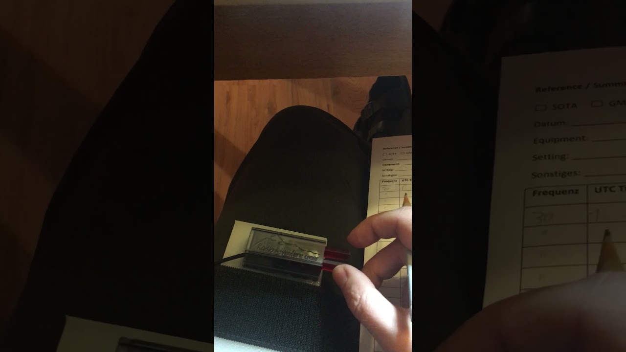

Thanks for your suggestions for a CW Sota Paddle, a few days ago i build the Radioadventure Paddle
It has a great Performance
73 Michael
73 Michael

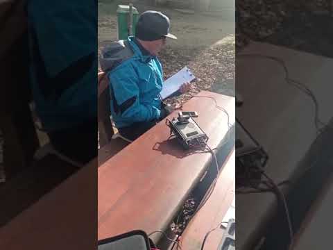

Today on DM/BM-210
