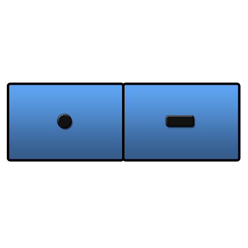

Morse Code Keyer even supports iambic (paddle) keying:
