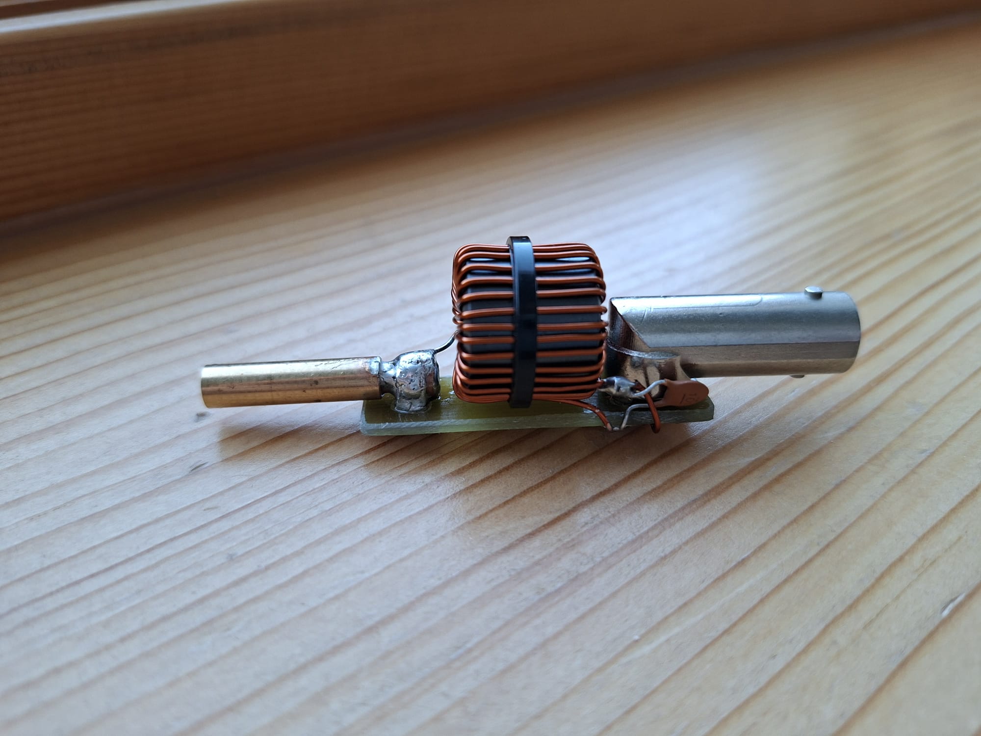

QMX is excelent choice if you want to hike light. Small, light, low current consuption. Small efhw and little rope is everything you need.
This is not my transformer, it is made by 9a7am. Mine is 5 times bigger.
