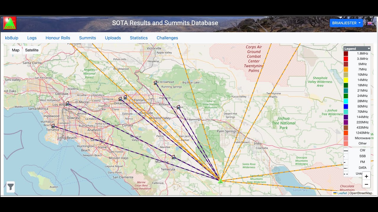

Here’s how to create a map of your SOTA QSO’s on the SOTADATA web site. When you login it will default to the Statistics tab. Under the Recent activations section, click on the map icon for a summit, You’ll see the map with a triangle with the points for the summit. The line color represents the frequency, for example dark purple is 144MHz. The line decoration represents the mode, for example, a dashed line for FM.

I note at 02:00 in your video, there’s a long QSO line stretching out over the Pacific to somewhere in China. This line represents the QSO you had on that day with KM6CEM who lives in San Dimas, Ca. The reason that line goes way off is due very probably to his having forgotten earlier to enter a minus sign to his position’s longitude (i.e. writing 117.799804 instead of -117.799804) in his QRZ page. The first one puts his position near to Suqian in China instead of his proper position.
He appears to have altered this at some time, however, and his QRZ page now shows the correct value. However, the SOTA record of his position, which that mapping page uses to place an icon on the map, has not been updated - you should contact the SOTA people to correct this.
The reason that particular line is separate from the others in the map? Most of the mapping engines (Google Maps, Leaflet, etc.) have problems showing such lines crossing the International Date Line (in the Pacific!) - it’s a well-known weakness, or bug in the mapping engines themselves. How each engine deals with this is slightly different, so … it is what it is.
KB8UIP de G4OBK
