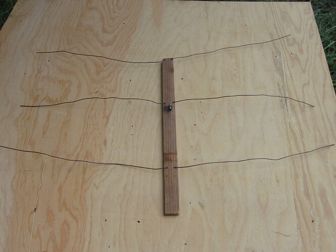

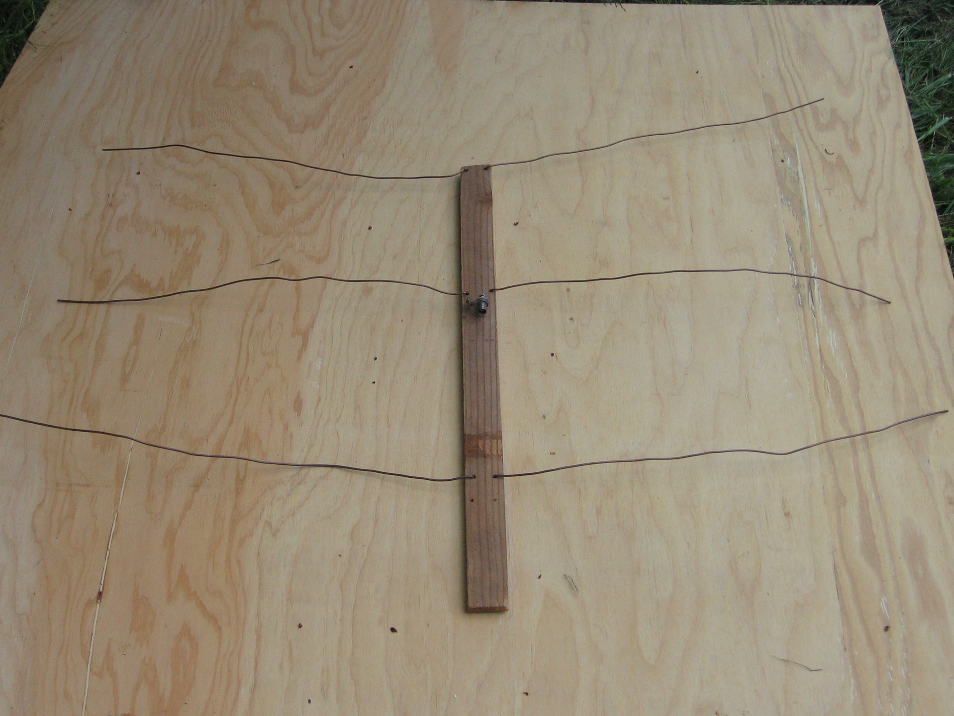

For cheap and easy to use, this is one of my favorites:
Just solid copper house wiring stuck through holes in the wood mast. I bend the wires parallel to the boom for transport. Article here. Weighs 280g with a short coax jumper and an extra wood piece at the back end to mount the radio.
Next step to reduce the weight is to use plastic water pipe and the connector blocks as shown in the photo in the article, along with aluminium TIG welding rods. If the pipe is jointed, then the whole mess should fit in a package about 50cm long, with the half-elements inside the boom.
For vertical polarization, the elements can just slip through holes in the boom up to some sort of stop in the center (perhaps a bend in the wire, or a wrap of tape). But it is prone to fall out for horizontal polarization if the antenna tips a bit. I also have some pipe clips (for holding a water pipe to the bottom of the flooring for under-floor heating systems) that I can add to the elements so they just snap onto the boom. Just a matter of acquiring the proverbial “Round Tuit”.

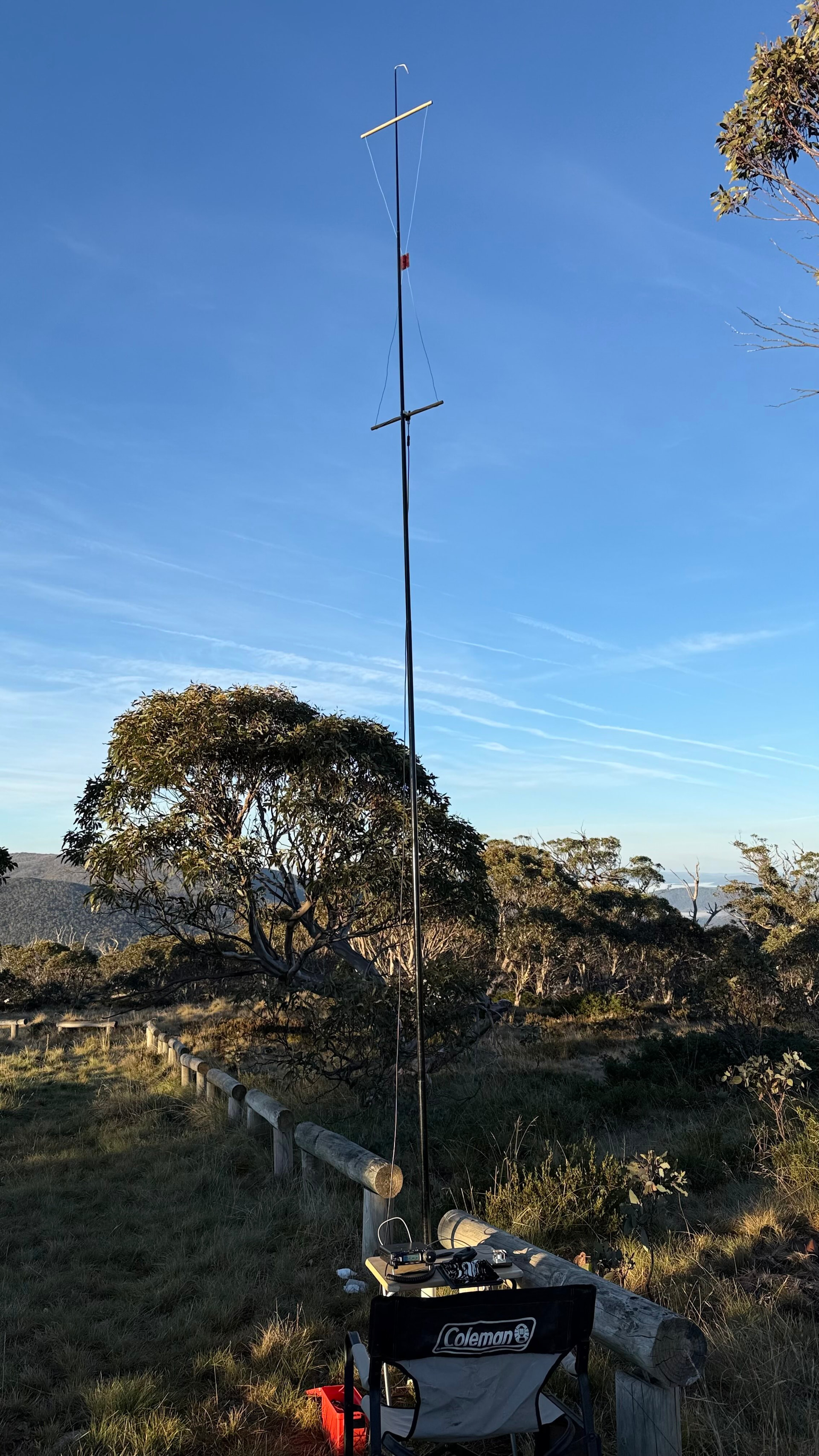

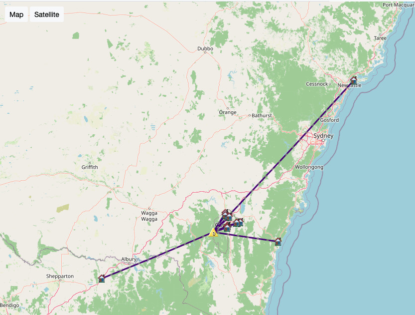

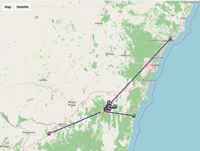

On Friday I activated Mt Ginini VK1/AC-008 1760m ASL and IMHO I achieved excellent results with an overall gain of 1300 km in 2m Dx contacts.
14 stations worked with notable contacts as far as 415 km, all on a 2m hourglass antenna at 6m above ground.
VK1AD SOTA station at Mt Ginini @ 07:19 am 1 May.
SOTA map
