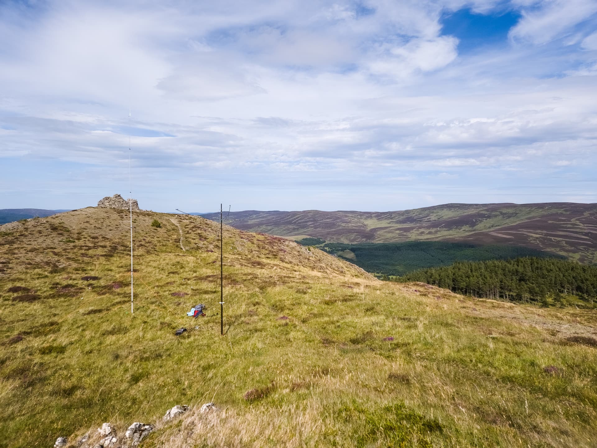

Even though the bands are pretty dire right now, it seemed a shame to stay at home on a great SOTA weather day, so yesterday I opted for a favourite local hill GM/ES-050, Coyles of Muick. Having listened to the bands earlier, hf didn’t sound promising so I took my 6m moxen along, as well as a new Gp with linked radials for 20/17 and 15m.
Equiment: KX3, PA50+ amp, Gp with 1/4 wave verticals for 20/17/15, 6m wire moxon. Sotabeams 10m travel mast and Tactical 7000hds mast
Arriving at the top, I saw a Whatsapp on our Deeside group saying that 6m was open, so I quickly got the moxon up. First itl was Fraser, MM0EFI, for his first 6m chase and also the first 6m QSO from the summit. The opening was limited and was very up and down, disappearing after I got 3 more itl (OE, DL and another GM, GM0PWS off the back of the moxon). With 6m having gone quiet, I put the GP up for 20m.
A spot brought a reasonable run of 18, given the current conditions, with Chris 2M0RVZ first itl. There was some decent short skip to G-land, with 5 including Denis MW0CBC.
Moving to 17m got 6 more itl, including another local, Alex, GM5ALX.
A final hf spot on 15m put 5 more itl, then it was back to 6m, which at first seemed empty apart from some French beacons and a 59 FT8 warble. Then found HB9HLM at 59, followed over the next 45m by 5 more, all from the same limited geographical area.

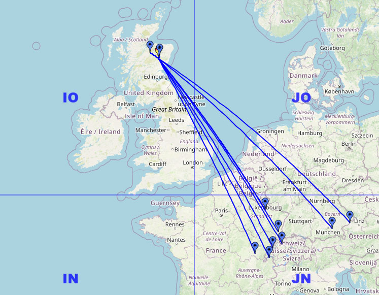

6m QSO map, courtesy cqgma.org
All in all, a very nice day out. Could have stayed longer, but the XYL was preparing supper, and I had to yomp back to the car to get home by 8-15pm.

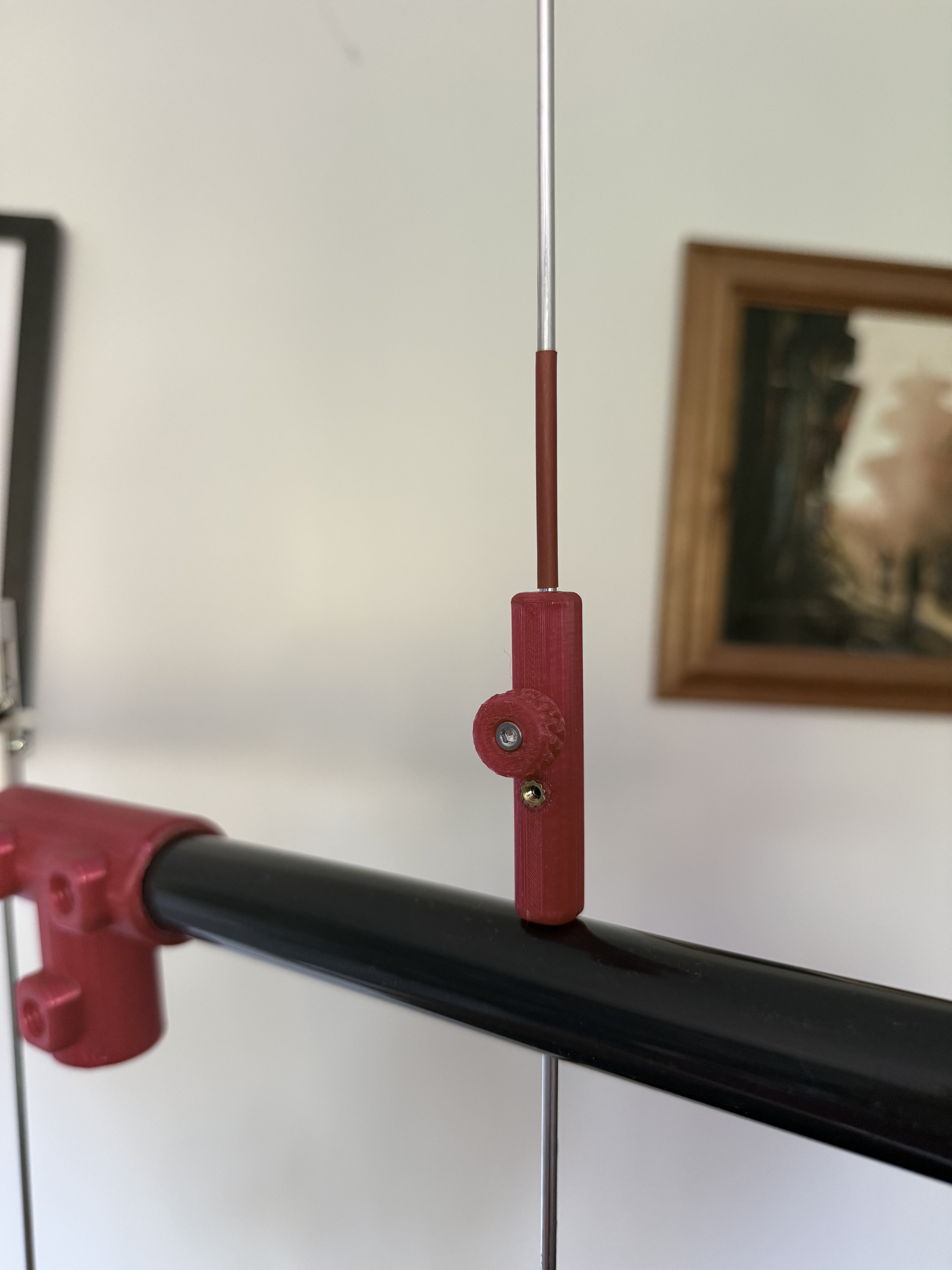

Probably what is needed is someone to spend a moment with the 3D printer and make a suitable mount for a fishing pole that fits high enough up and allows easy assembly of 2 elements to make a horizontal dipole. Maybe also a joining block so the elements don’t need to be 1.5m long but assembled from 4x 75cm lengths. A bit like the things in Tim’s @G5OLD offcentre Yagi.
Fits on a tactical mini, or is configurable to any diameter with a plastic compression bolt.
This prototype is currently somewhere in the Fisherfield forest if any cares for a free one :rofl:

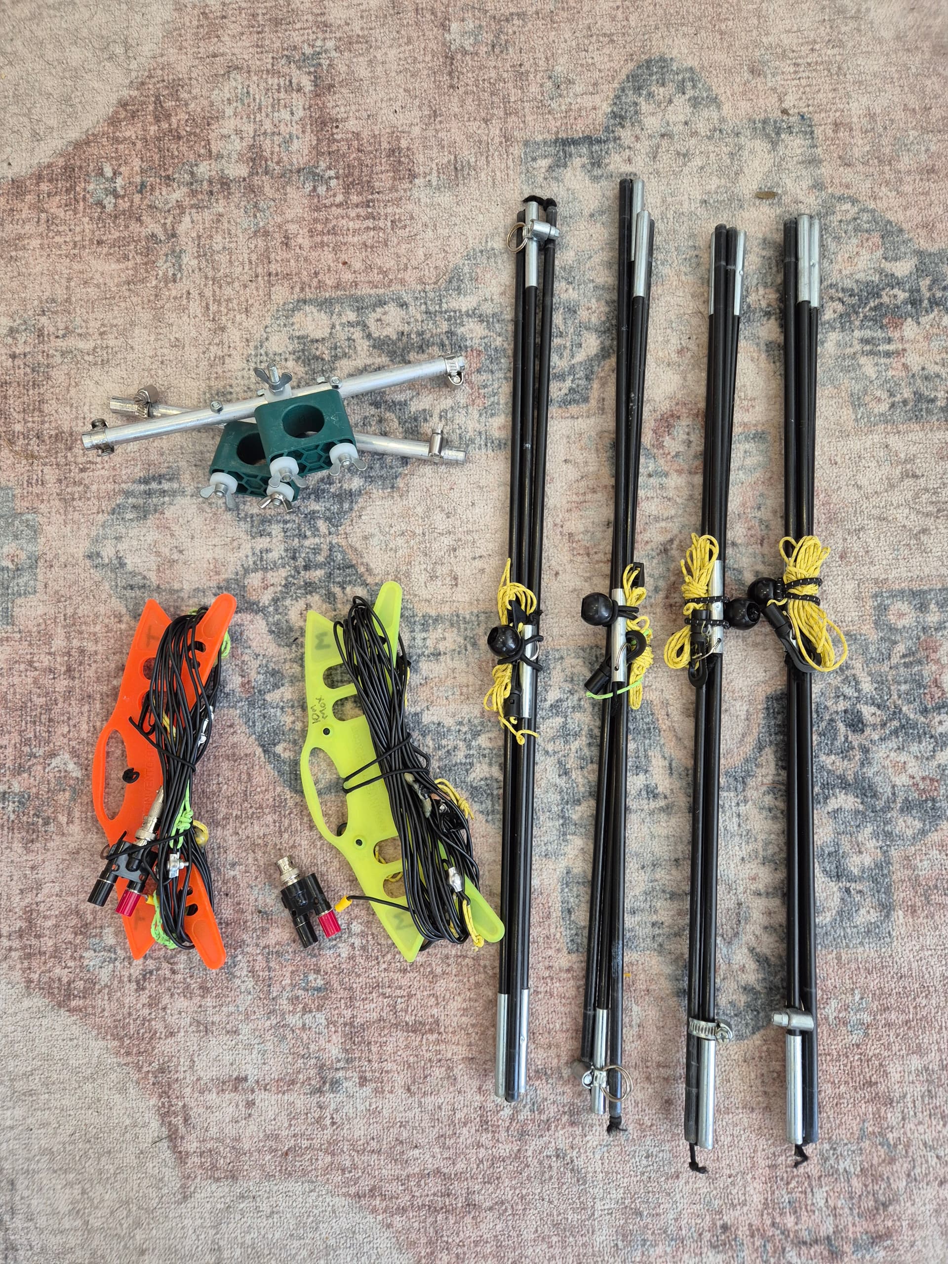

I don’t consider my moxon too large, and its sized for both 10m and 6m. The whole thing weighs 1.5kg (including both 10m and 6m wires) and takes 5 minutes to assemble once the mast is guyed. The trickiest part to construct is the hub, which is the design shown by MM0OPX on his Youtube channel. The rest of my build differs from his in having spreader tensioners and BNC banana plug adapters to directly connect my Airborne 5 coax. feeder.
