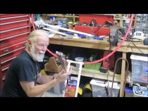

QSO Today, John W6NBC, Practical Metal Foil Tape Antennas might have some ideas.

Interesting video. Thanks.

Here is one!
