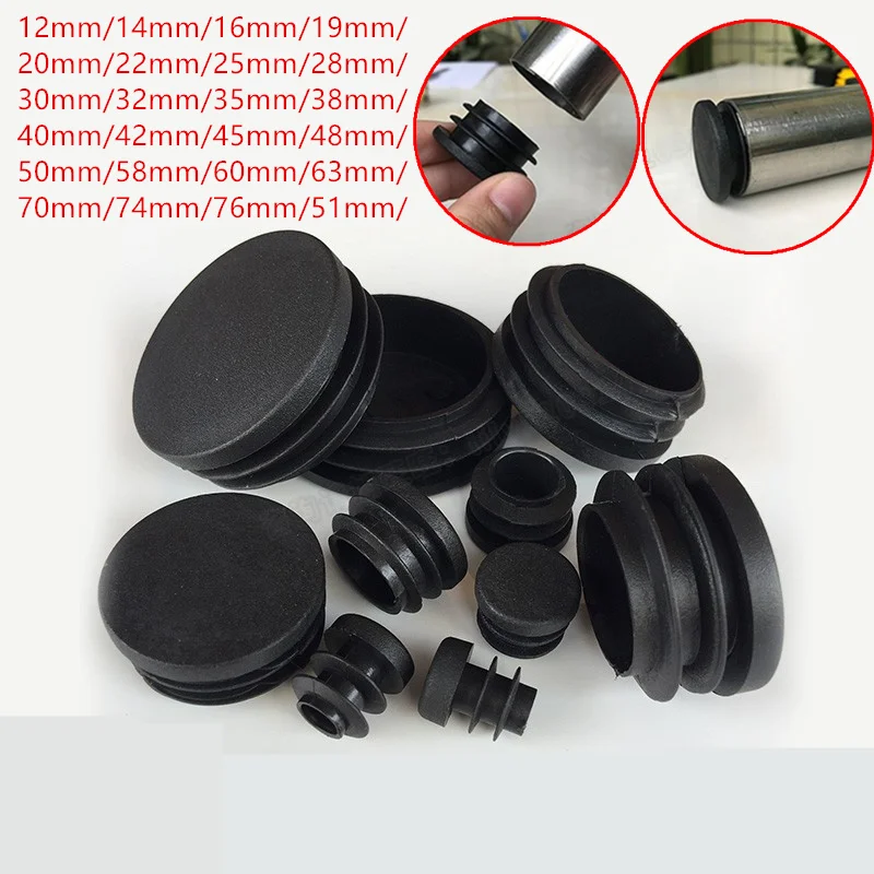

Jon, could you, please, add a little details about using materials except antenna.
As I understood, it built from pipe and black cork or what is it?
Thank you in advance,
Yury.

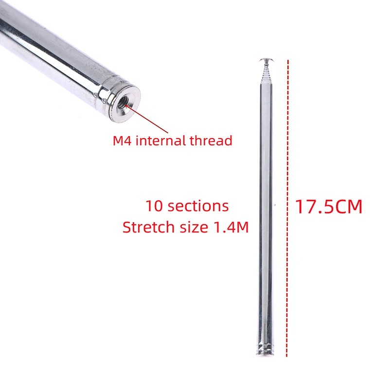

Where can I get a telescopic antenna like that?
What is its lenght?
You can buy these either as a replacement whip AXW1 (about $10) from an Elecraft dealer or on eBay e.g. here, either 1 or 4 pieces:
To be honest, I don’t like Elecraft antenna because it is short.
I would recommend to find something about 1.8 meters long.
Here’s example with length 1.85 meters
Yuri, here you are the caps that I used.
The antenna whip.
Acabo de encontrar este increíble artículo en AliExpress. ¡Échale un vistazo!
3,40€ | Antena aérea telescópica de repuesto, accesorio Universal de 1,4 M, 10 secciones, DAB AM/FM, 1 unidad
