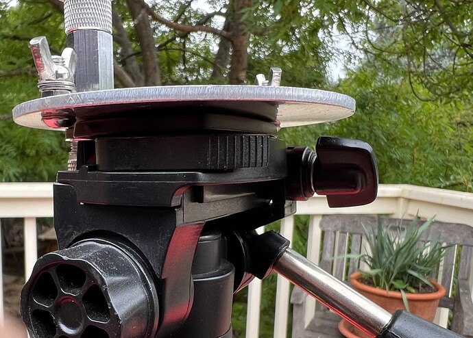

Here is a different solution which involves a 1.4m telescopic tripod, yes a tripod will add more weight to the backpack. Note the telescopic antenna is supported by a 19 mm plastic sleeve and an end cap, which transfers any wind load into the tripod head plate. You can use a sleeve in combination with the popular spike mount.
The solution is best explained with photos.
Tripod assembly. Four 5m ground radials connect to two M5 screws and wing nuts on the aluminium plate. The telescopic antenna is mounted on a 3/8 UNF 24 TPI socket. The knurled adapter is M10 to 3/8 UNF.

Tripod dovetail head plate
Underside with the dovetail head plate mounted using a standard 1/4 inch BSW thread.

Without the additional support of the plastic sleeve the wind loading is on a narrow section of the crimp base which is very likely, almost certain to fail!
The 300 mm sleeve now supports the bottom section and transfers wind load to the tripod head.
