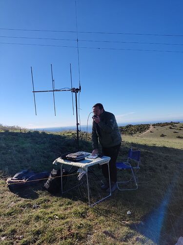

Hi Mark,
Here using an Arrow II (twin band 146/437 with duplexer, one cable for booth band)
About 0,56Kg, I’m using a audio recorder because one hand are on the antenna but you can use a tripod :+1: and write your QSO.
Here I bought this antenna because a local supplier had a good price !
You can see here my last test in V/UHF as TM15SOTA SOTLAS
The VHF DX was F4DIA at 96Km and you can see the result. 5w Ft-4ex
One link better after Brexit Arrow Antenna Hand Held Portable dual band 146 437 440 arrowii Yagi Satellite
73, Eric
F5JKK
