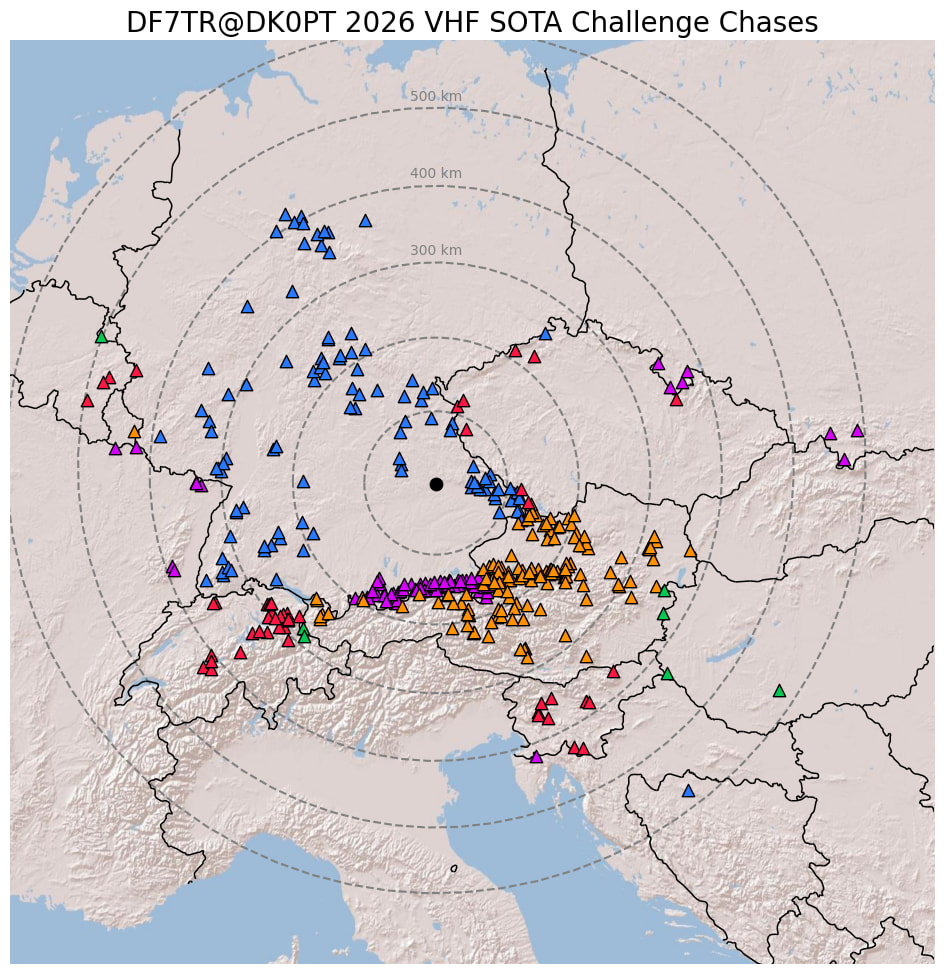

I’ll save the long story for a possible final post after the challenge. For now, I just want to tell you the following after showing you the following plot, which I will explain in more detail later.

Meanwhile, I’ve worked 513 unique summits in the challenge this year. 389 of them were worked from DK0PT, and 189 were worked as S2S QSOs (with some overlap of course). The plot above shows all the QSOs I’ve made from DK0PT this year. I’m incredibly grateful to be able to use such an amazing antenna with 4 × 12 elements for 2m almost every day. I really feel like I’m in just the right place at just the right time! :face_with_hand_over_mouth:

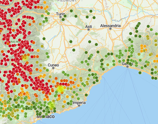

A few months ago, I was browsing sotl.as, when I realized that the line of red summits in the Alps stretches all the way to the Mediterranean coast. Especially the summits in the Southeast of my following screenshot should have an amazing takeoff in my direction, at around 30°.

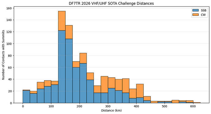

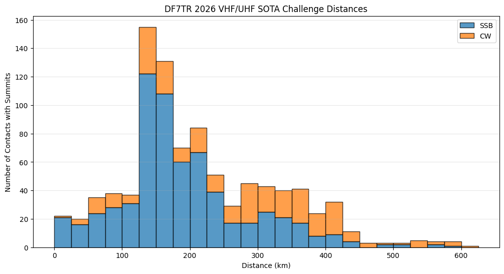

I made this plot, to see, which mode I used to chased summits at which distance. This plot does not just include the QSOs I made from DK0PT, but also all other 2m SOTA chases, which are moslty S2Ss and also multiple contacts with the same summit.
There are two things in this plot that I want to point out in particular. You can see the big number of QSOs between 125 and 225 km with DL and OE alpine summits. 2m activity in these regions is high and many operators are taking part in the challenge. Especially the summits in the first row of the alps provide great opportunity for 2m!
And you can see the power of CW, which becomes the dominating mode for me for distances of 350 km and more. All opeartors I know are able to work SSB, but not all are able to work CW. At these distances, CW often made the decisive difference! I want to encourage everyone to give CW a try :grin:
