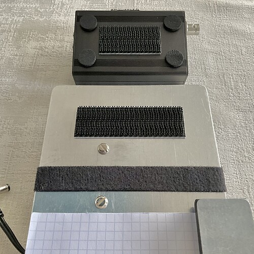

Same QMX, same key, same cover… Would be curious to learn more about your short antenna (coils, and experience compared to full size wire), and if/how you fix the battery under the plate, for inspiration…
To answer your questions: In the photo you can just see the anti-slip stoppers (fix-o-moll) glued to the setup under the battery and 2 short posts to the side. This holds the battery perfectly in place when a Velcro strip is tightened around the setup.

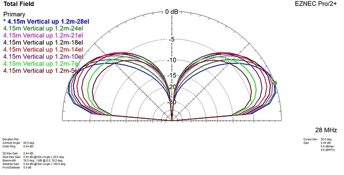

The short antenna with omnidirectional characteristics and flat radiation angles for a light 6 m carbon mast was built years ago for experimental purposes.
