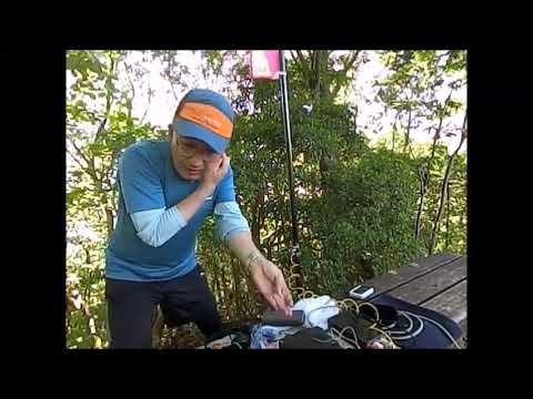

The following video shows a recent my activation using a carbon rod.
The antenna performance was improved dramatically even in 14 and 7MHz bands. It apparently indicates the contact resistance at the feeding point is significantly influence antenna performance. I believe connection between sections are capacitive making the effective antenna length shorter but no harm for efficiency.
