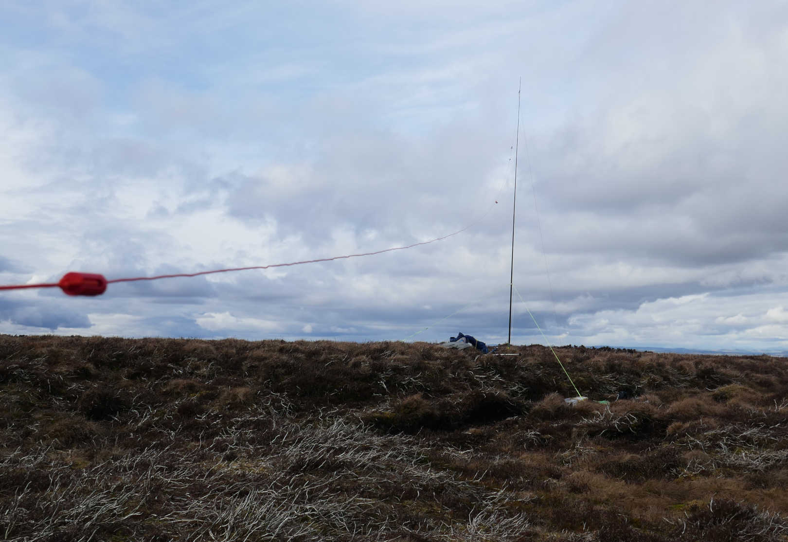

Up with the pole and then first attempt using it in anger. I used my modified Hamshop.cz 40/30/20m trapped EFHW with the original match unit replaced with an AA5TB unit. This tunes up fine on 40/30/20/15/12 & 10m but will not tune on 17m at present. That’s something to work on next. I was worried that the carbon in the pole may detune any antenna effectively touching the pole and I’ve been having good results with the EFHW as a slopping inverted L, i.e. approx 5m vertical then slopping from 5m to 1m AGL. I was able to set up so the vertical part was sloping away from the pole so it was about 50cms away from the bottom.
A picture tells a 1000 words. Looking up the slopping section to the pole, the vertical section is to the right of the pole.

What I was pleased with was that the carbon pole worked very well and didn’t seem to have any effect (well maybe 40m but I’ll dig further on that). So that’s a tiny, super lightweight pole to use. This will be part of a NSAP along with a pair of QCX minis (20m/30m) and maybe this antenna or maybe something just for 20/30. What’s NSAP ? It’s Andy’s “Next-generation SOTA Activating Protocol”. I know I can take an 817, paddle, mike and some antennas and reel in chasers. NSAP is going to be using tiny lightweight radios, batteries and antennas. Something different just to make HF a little different. Oh, and there’s a KX2 coming too :wink:
