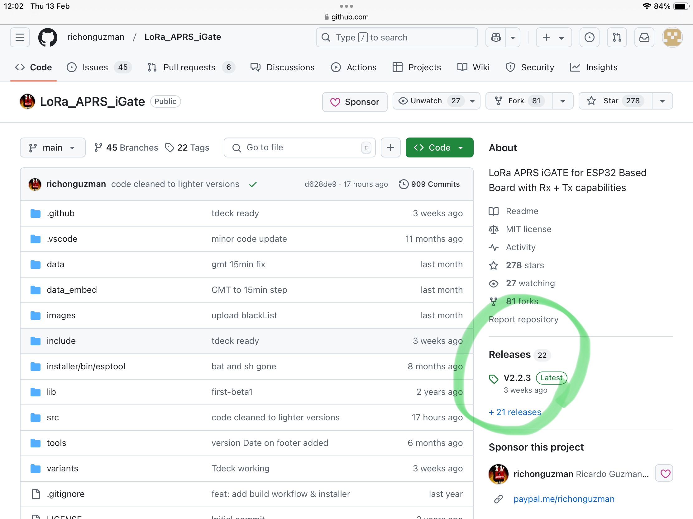

Yes I use it for updates.
Click the releases on the igate firmware page, circled in green in the picture below, to get the device specific list of zip files.
Download the zip file for your device, unzip and in one of the folders there is a file called firmware.bin.
Open the web configuration page on your igate, select the OTA tab and the when prompted for a file use the .bin file that you have downloaded.
Done :smiley:
The configuration should be intact but sometimes I get a message ā€œconfiguration could not be loadedā€ but rebooting the igate seems to fix this without having to reconfigure.

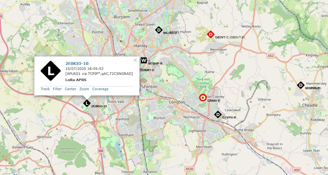

2E0KIO-10 is up in its temporary location. took a few attempts to set it up but its working. I’ll move it into the loft space and run some power to it in a few weeks.

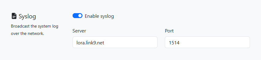

As you are using the CA2RXU igate firmware, you can set it to upload all data it hears to this site: https://lora-aprs.live/ via syslog (see https://lora-aprs.live/help.html) - or set up your own syslog server on your network - it’s quite interesting to see what your iGate is hearing but is not necessarily recorded by APRS-IS.

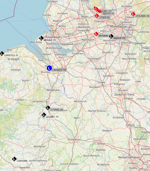

These are the eleven stations which iGated me on Thursday morning (sometimes I’m heard by as many as twenty):
