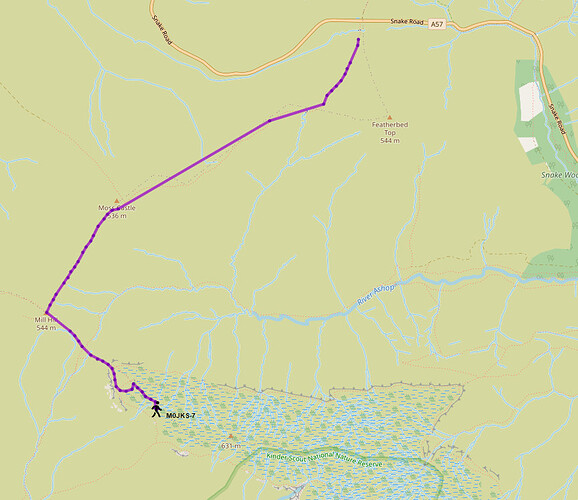

I’ve just been running my IGate to track Dave M0JKS heading up Kinder Scout. I was getting him on most of the ascent up from Snake Road, but once he got past Mill Hill, several other stations were picking him up too.
Yes, he’s working well :slight_smile: @G1JKS

My iGate has reported a few packets coming from more than 80km away, but nothing much further away than that. Usually the more distant trackers are better received by other iGates nearer to them. My iGate did contribute a fix or two to at least one unusual track yesterday, though. I assume G7HEM-11 was aeronautical mobile… :wink:
Yup! :slightly_smiling_face:
