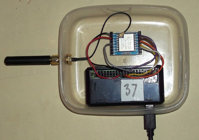

I’ve now got a new microSD card and put together one of these, using an old Pi2B coupled to a little Ra-02 LoRa board:
I’ve just set it up as G6GVI-10 and tested it with my portable tracker (G6GVI-11) on the shed roof.
Interesting to see that it reports the SNR & RSSI values of the received signal too:
