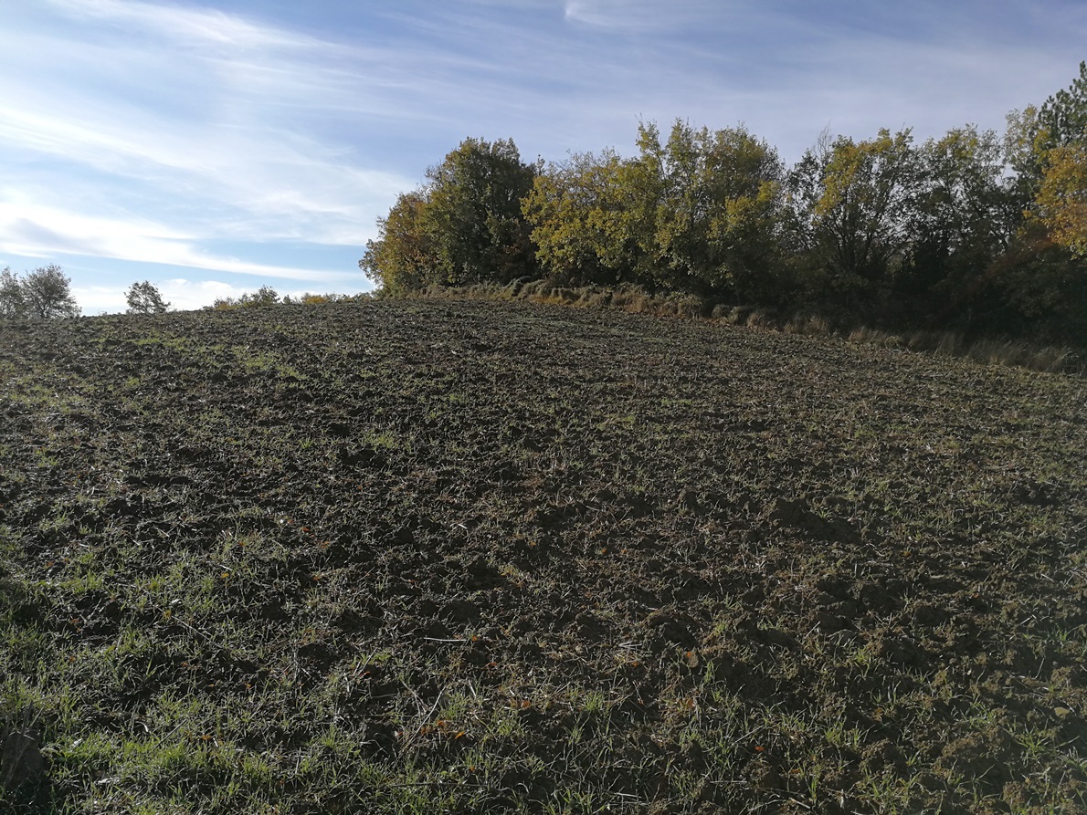

The path started flat and easy and follow a steep section mid way, but once aproaching the summit you have to continue passing by a field.
That part was very hard to progress as the farmers have started to plow the fields. It was all wet and so soft that my boots started to get weight and suddenly I discovered they were like muddy flip-flops!
I was only happy that I had put my gaiters in advance to protect a bit my trousers.
The very last part was ugly; there was no alternative to exit the field as there were plenty of thick bushes around, no way to exit but you could only get on…
