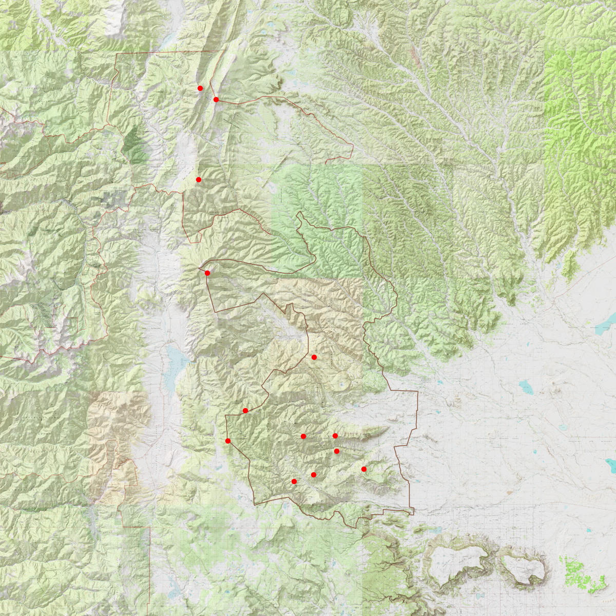

Yes, Caltopo is great. I used it to combine layers for the Philmont Scout Ranch boundary and SOTA summits, then edited the summits to those within the ranch. That map is published at this URL.
I wrote a blog post on it with more links.
wunder

Walt, I am still on training wheels when it comes to Caltopo, though I use it quite a bit now for activations. How did you overlay the Philmont boundaries with the SOTA summits contained therein?
Have you ever layered in anything from Gooegle Earth? I read on Caltopo about a limitation involving Google Maps, at least when trying to print to a geospatial PDF, so not sure anything from Earth can be layered other than for online review.
Thanks.
73 Paula k9ir
I’ve been using the free version of Caltopo for the past 2 years and it has been saving all my maps just fine. I don’t see any limitation, but I don’t try to save PDFs.
Just share the link to your maps and people can generate their own geospatial PDFs on the fly.
