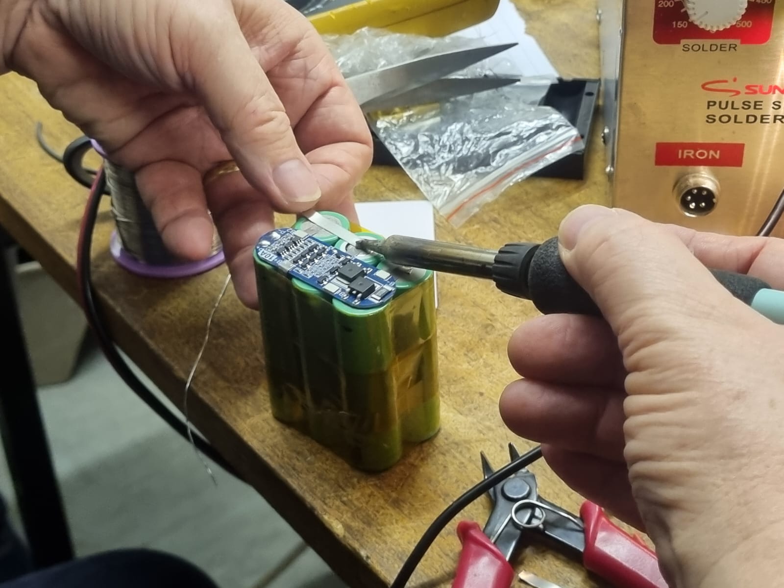

Going to build a battery pack out of 6 x 18650 batteries, but i need to wrap the pack to protect it once assembles and top make it lass cumbersome to use! But what size and type of wrap do i need?? the more i se on amazon, the more confused i get! haha the batteries will be laid out in a 3x3 format with the BMS ETC on the top, one wire out for charge, and the other out for power!

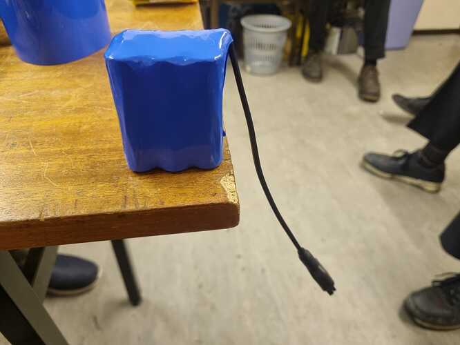

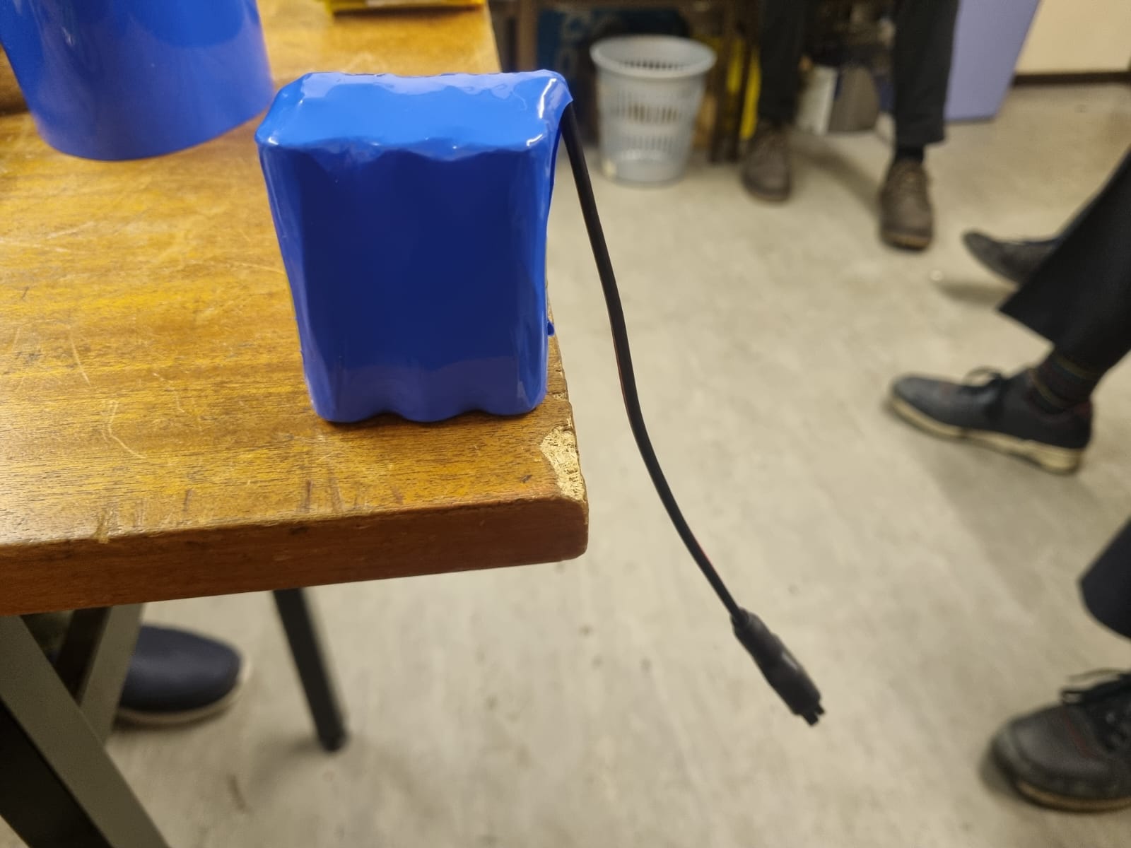

Normally, the size refers to the width of the wrap laid flat. So to find out the size you need, wrap paper around your proposed battery pack, fold it in half and measure, then add a bit.
we very successfully built a battery pack in club and wrapped it :slight_smile: Thanks for the advice all… 120mm was the diameter :slight_smile:
Cheers all!
