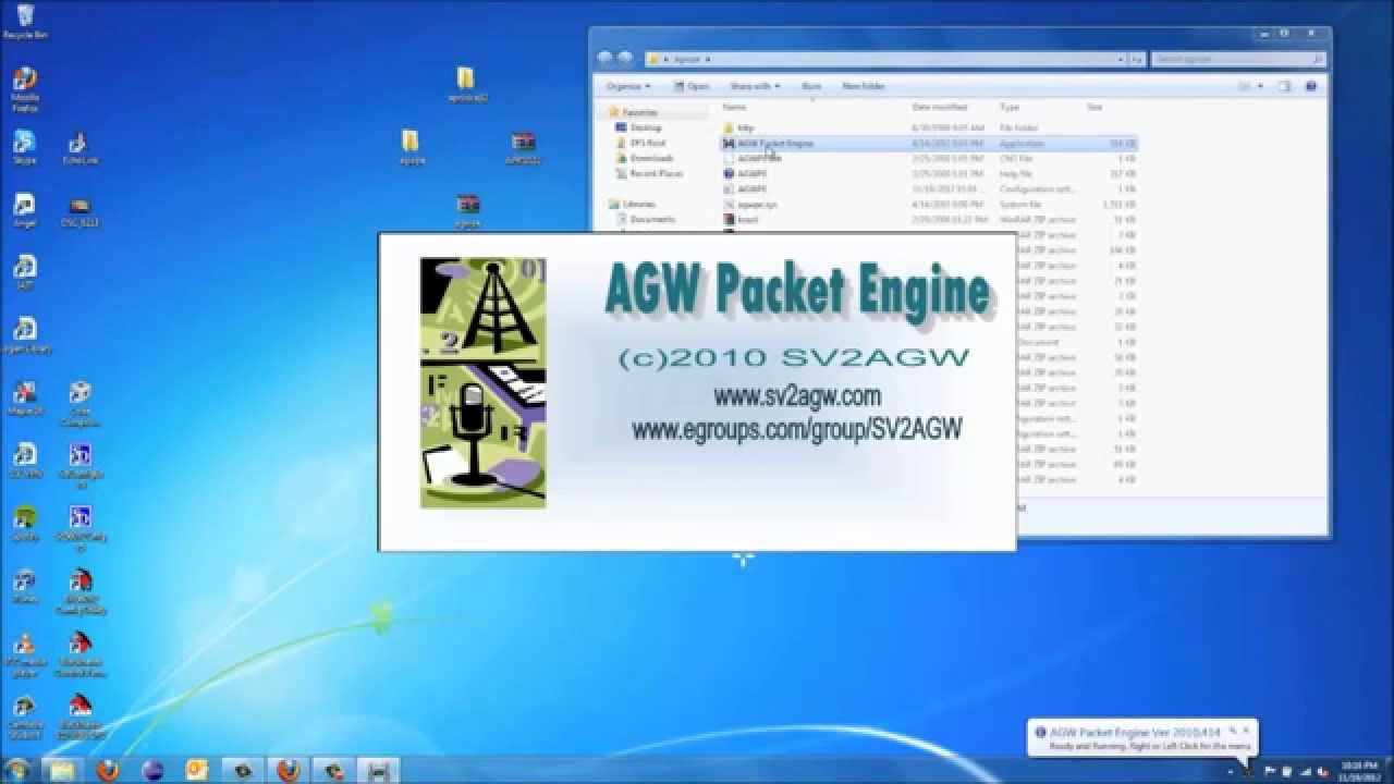

The iGate itself is fairly simple.
I initially did this
I used a spare netbook, colinear and Yaesu VR-500 Scanner. This system convinced me that it was worth investing in an APRS system.
