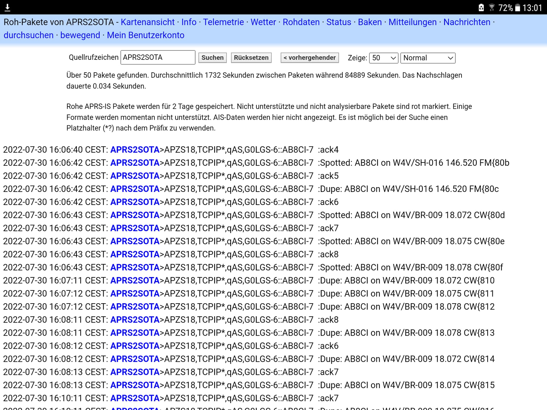

Yes, I was able to successfully place a spot on my Anytone. Before that, however, I had typos in my code, and therefore no feedback.
However, you can view your raw data and corresponding error messages on aprs.fi. Here is a screen copy.

Surely you have already registered at https://www.sotaspots.co.uk/.
You can check your code by looking at APRS2SOTA on aprs.fi
