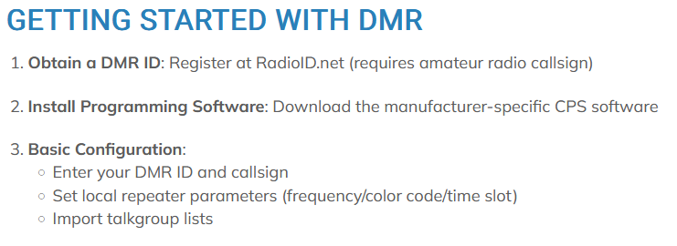

From boafengradio.com:
See if the repeater you are trying to access is on the Brandmeister network. If it is, you can go on the BM website to see if there is any activity and check if you have set it up right.
I’ve only ever accessed a local repeater with DMR and performed some functions on it (e.g. change talkgroup). Never had a contact using that mode.
It once took me some time to get the hang of programming the codeplug for an Anytone DMR 878. I highly recommend using PC-based software for this task. Many things can only be configured on a PC.
Here is some information provided by an AI:
RT4D Codeplug Editor: A more modern tool created by developers within the community (available on GitHub) that is specifically designed to parse the .4rdmf files used by the RT-4D. It allows for more organized management of the 1024 channels, zones, and DMR contact lists via a PC.
