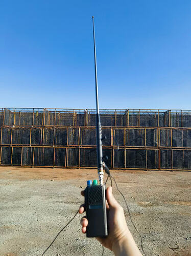

Hi VK3YY,
I’m BD3PXM from China, I followed your HFJ-350 20m band modification method and rebuilt my DIY QRP handheld transceiver with this antenna.
The efficiency and DX performance are far better than I expected in my field portable tests.
I’d love to keep exchanging test data, tilt angle tuning tricks and matching adjustments with you, let’s work together to squeeze the best possible efficiency and long-distance DX capability out of this compact whip antenna.
BD3PXM, JO39eq

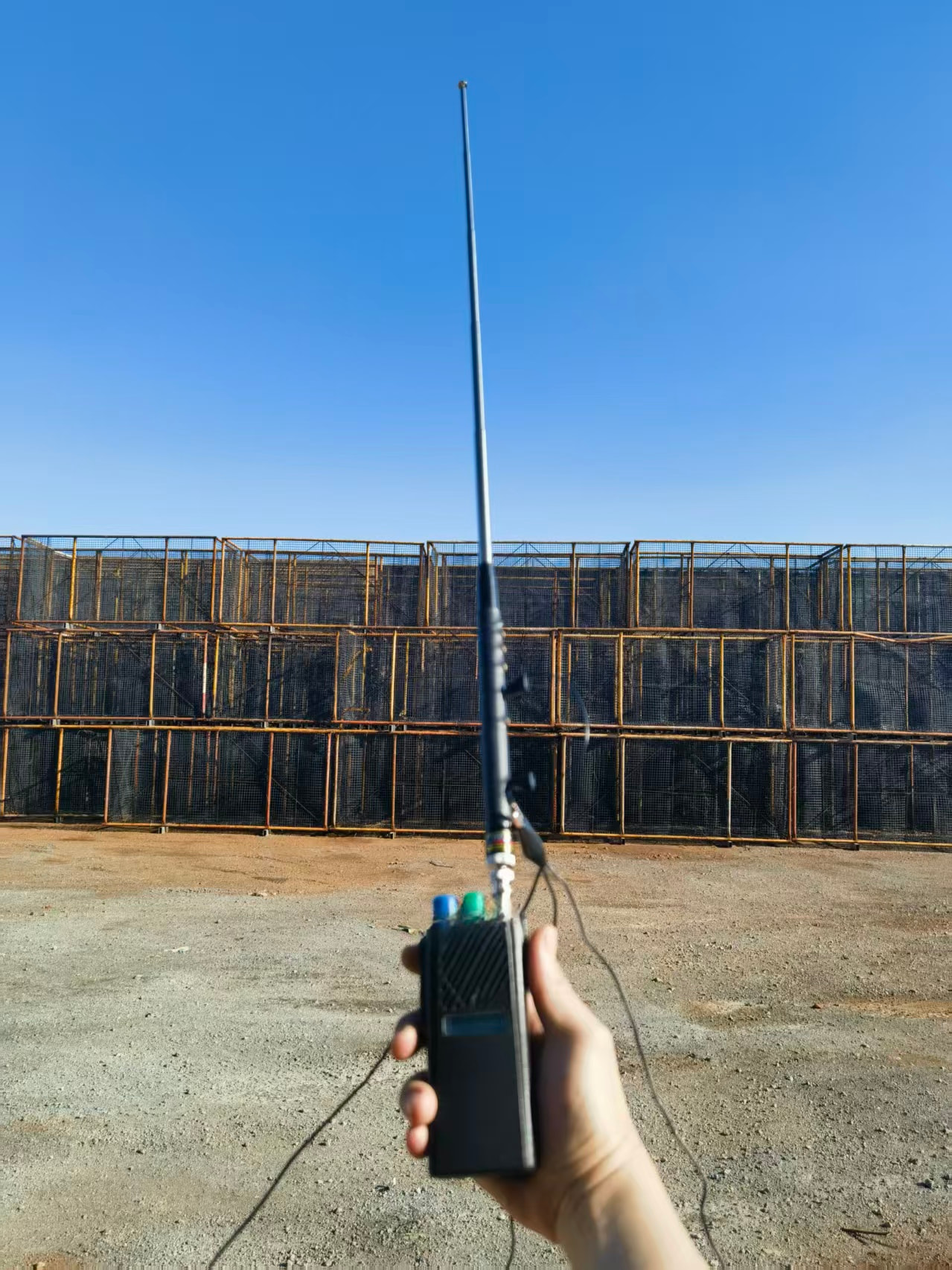

Hi VK3YY, BD3PXM here.
I tuned my Comet HFJ-350 20m whip to 89cm for my DIY QRP handheld rig.
My operating spot: 6-story building behind me, metal cages 5m high in front.
Under this blocked environment, I can easily hit domestic stations within 1000km, and completed a 2300km QSO with Yokohama JA on 5W.
I’d like to exchange tuning ideas to maximize this antenna’s efficiency together.
73 BD3PXM, JO39eq
Hi BD3PXM,
Nice to see that your Comet antenna is working well. With the right length ground radials, it can make some distant contacts.
What type of HF hand held radio are you using?
Glenn VK3YY.
I operate a fully homemade four-band QRP HF handheld SSB transceiver with 5 watts output power.
I use an 89cm loading whip antenna, matched with three 5-meter counterpoise wires.
My operating environment is extremely poor: there are metal cages in front and a six-story residential building right behind me, causing severe signal attenuation and interference.
I have made a two-way DX QSO with a JA ham in Yokohama, around 2300 kilometers away.
Every single QSO has been fully recorded on video as evidence.
BD3PXM JO39eq
