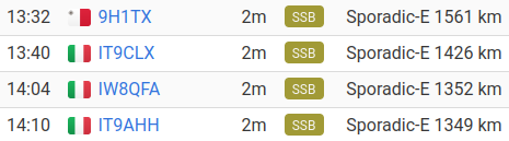

I’ve heard of the first challenge QSOs via sporadic-E today! Mathias @DH1WM already uploaded his log - he made 4 amazing QSOs from FL/VO-126
and Michael @DB7MM also worked 9H1TX with just 10 W on his HB9CV antenna! Congratulations to both of you! :partying_face: :flexed_biceps:
