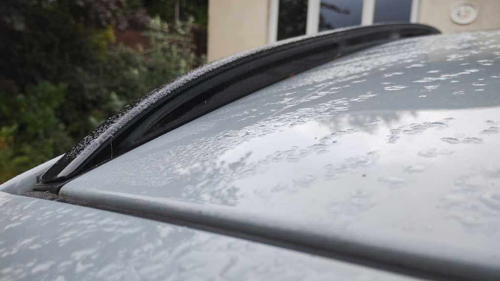

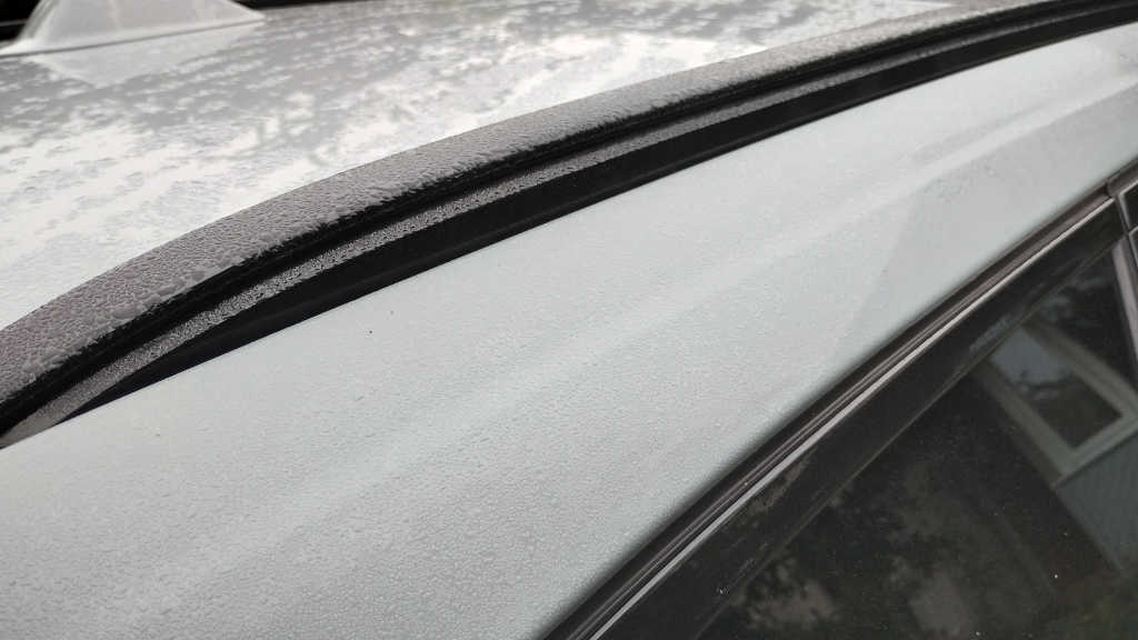

If it is similar to my motor it would look along these lines. The roof rails are flush to the roof with no gap underneath, so any roof rail mounts you would buy (e.g to mount a roof box) would look like this:
The rail is approx 30mm high from roof to tip. 25mm wide and the groove is the top 15mm. Everything is flush and there’s no gutter any more as they cause too much drag. Last car with a gutter (and thus had a gutter mount) was sold in 1998!

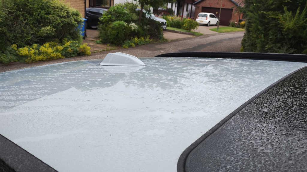

The other issue is there is a panoramic sun roof. A sun roof in Scotland? Yes, I know! It takes up about 50% of the roof. I’m not sure there’s enough roof area for a mag mount to work without bonding straps.
You can’t use a tailgate mount as there is a spoiler in the way. The black gap is where the tailgate opens and the spoiler is bottom-left. It’s plastic.

Sounds like we have more or less the same issue. I’ve a panoramic sunroof as well (in Ireland, basically Atlantis).
Mag mounts would be alright but not centred on the roof. Another reason I ended up just taking the easier (perhaps less cost-advantageous) route and going for the K400 and ATAS.

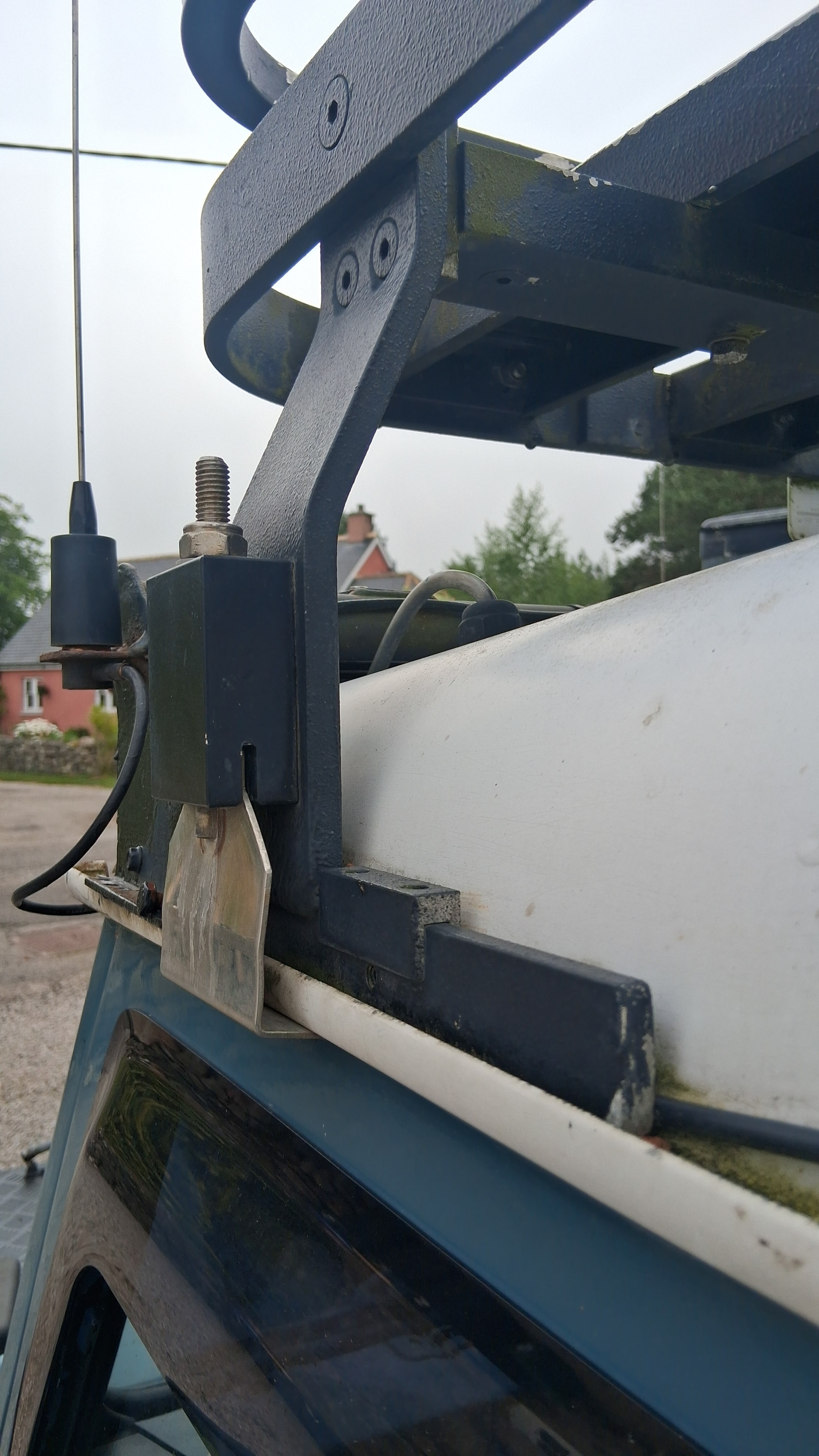

Gutters were so sensible though, I had roof bars that mounted to the gutters, an antenna mount etc. I got fed up with mag mounts not holding at motorway speeds. I had a lovely on glass sticky mount that was fine for 70cm antennas. It looked like a cellphone antenna mount of the 90s.
But gutters went away because of drag… not an issue with Landies TBH as you don’t blast along motorways and there are worse sources of drag to be considered first. That roof rack looks well sturdy ![]()

I may or may not have had 300kg of plasterboard on it, when doing my sons bathroom last year. ![]()
