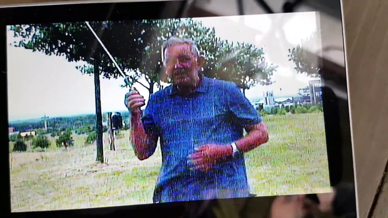

Was on in 1956, 432 MHz, with a 5527 iconoscope; great tube, when the sun was out!
Pretty lonely, then; am certain that would no longer be the case, especially with the enthusiasm of SOTA participants.
