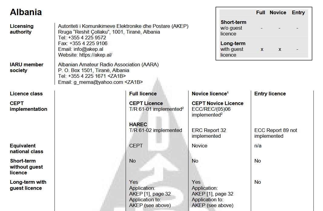

Hello Jacek!
See the screenshot underneeth.
That’s what I am referring to. For example compare it with the rules of OE.
vy 73, Franz
ZA/OE5FSM/p
The screenshot is nice, additionally a link would have been better. It seems that the fine print in footnote 2 (not shown) takes away / restricts / makes access difficult in contrast to what is promised in “T/R 61-01 implemented”.
73 de Martin / HB9GVW
Yes, agree. In theory TR6101 should mean I turn up and operate as ZA/G4LLD/P on Albania allocated frequencies etc. with no more admin needed. I suppose it’s a bit like Malta used to. There you could have a 9H5xxx call if you had a CEPT approved licence, now you just operate as 9H/G4LLD/P etc. But it’s just a wee bit of extra hassle to arrange.

Franz is right.
I like to verify at the source, which is why I noted in my earlier post that I hoped I wasn’t mistaken. As it turned out, I was wrong. The DARC and CEPT data are of a high standard, but you should always check the local radio regulator to see which regulations apply at any given time, or the national amateur radio society (which is not a source in itself, but is nonetheless helpful).
We live in an age in which language barriers are gradually fading. I hadn’t had time to check earlier, but I finally looked at the websites of the Autoriteti i Komunikimeve Elektronike dhe Postare (AKEP) and the Federata Shqiptare e Radioamatorizmit.
I found useful information confirming Franz’s data on:
https://fshra.org/faq/
as well as on the AKEP page https://akep.al/wp-content/uploads/images/stories/AKEP/rregullore/2017/RREGULLORE_PER_SHERBIMET_RADIOAMATORE_2.pdf — the details are given on page 5 of that document.
Chapeau bas, Franz
Vy 73 Jacek SQ9MDN
