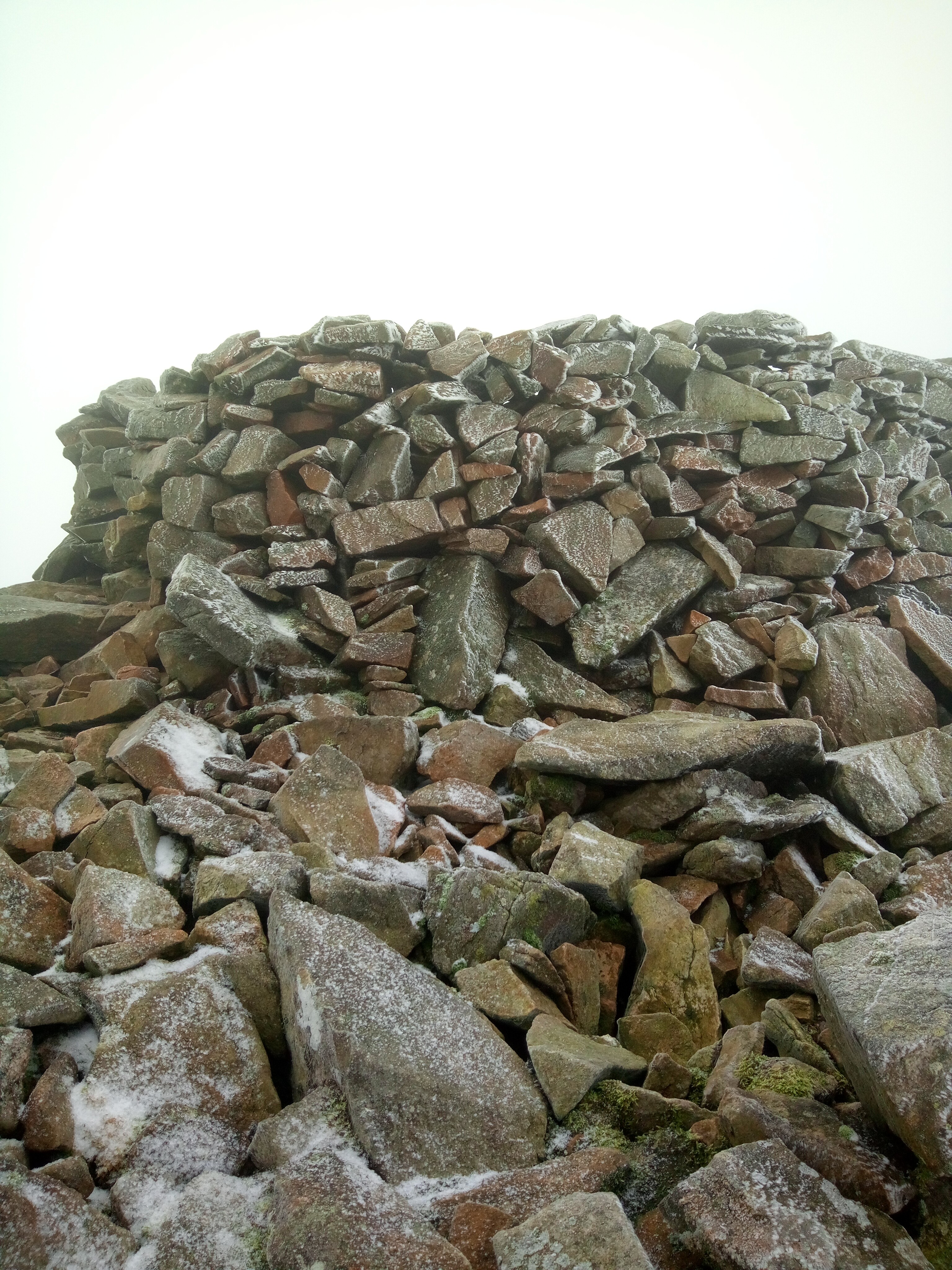

I don’t really like setting up the station in the cairns, but I had a look round the summit and, in the conditions, and wind it was the only realistic option, as I wanted to be there for a couple of hours. I set about on 2m and could hear some other Summits out there, so I chased them down first. Ended up with S2S with John GW4TQE/P on GW/NW-061, John GW0MHF/P on GW/NW-043, Adrian GW/MW-009, Iol MW7IOL on GW/NW-026 and Shaun G6WBS on G/NP-010. Also got four of chasers ITL included the ever-reliable John GW4ZPL and Frank MW0OFA. I’d set up on the Yagi when I managed to get Shane with the S2S and then just managed to work Ben GW4BML, when we synchronised our beam pointing! :wink:

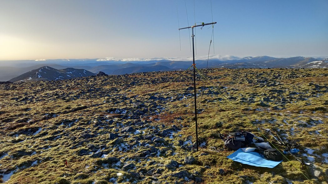

It’s one of these Richie.
I sacrificed a section of fibreglass fishing pole to make it and then used another couple of sections for the mast. The elelents go inside the boom for transport and the boom goes inside the mast. You need to make a simple choke too.
I was jrunning 40 watts from my ft-857d through two metres of rg8x. Height is anout 2m. Yours must have been a lot higher?
That’s excellent Fraser, I’ll take a look and have a go at making it. I was 5 watts through a FT817ND. The yagi was on a 7m pole, which due to the wind wasn’t fully extended, so I think it may have been about 3m, you can just about see it on one of the pictures sticking out of the cairn on the right. Even when I turned the yagi into the correct direction, I know for you that my audio got better, but yours stayed the same. So I’m thinking that maybe your signal was bouncing back to me from the Snowdon Massif or Glyderau?

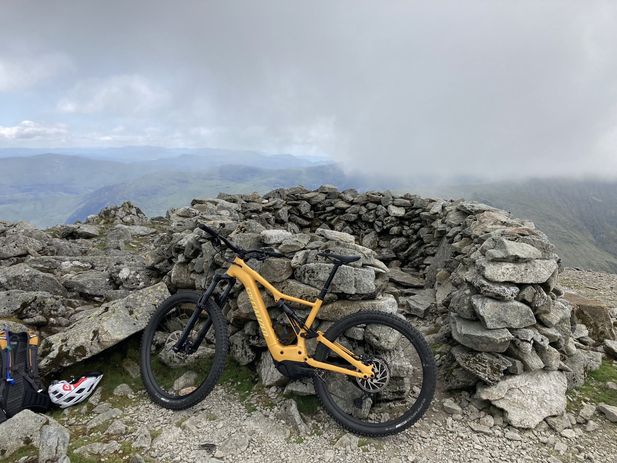

Great report Rich and pleased you got up into Scotland. Weather conditions weren’t good for loitering. I’d ridden / fought with my bike up Mynydd Mawr so was toasty to start with. Like you, plenty of action and support. I can’t compete with Scotland but contacts as diverse as Swansea & Pen y Ghent were pleasing. Here’s my base yesterday, posted elsewhere a bit randomly.
By the end my hands were so cold my log looks like it’s been written with the pen between my teeth. The ride back down to Fron was a little hairy, I was struggling to feel the brake levers!

Far play getting up there on your bike, I need to sort mine out after a wrecked the back brake last time I was in Llandegla. Was the track ridable all the way?

I’d suggest RF feedback. In fact I’d put money on it :slight_smile:
The transceiver is close to the antenna and you are running a bit of power. Placing a handy sack of salty water and lard (yourself) between the radio and antenna may help. In the piccy, the antenna is vertical and the feeder is hanging down amongst the elements. Ideal to pickup lots of RF current on the outside of the feeder shield and cause problems. The feeder hanging down in the elements is a common issue with amateur vertical Yagis and all solutions involve some engineering and thus add weight and usability issues for SOTA activators.

The track from Fron is rideable, it just gets too steep for a short while. Even with an eBike a bit of pushing was needed to avoid a backflip or simply losing traction. Although it’s got powered walk-assist you still get the “feedback” your cajoling a 50lb bike uphill!! On an acoustic bike I’d say doable, some tough pushing in places and a cracking descent as payback. eBikes are bonkers. They still need you to put in a shift but you can climb over surprising ground. That one has been to the top of Carnedd Llewelyn. Last May, before my childhood interest in radio boiled over and led to SOTA
They also descend incredibly well, I dropped into Cwm Pen Llafar, totally off piste. Very hot brakes!
Now if I could just sort out a full licence and connecting my radio to the 500Wh bike battery I could run a 400w rig on one of the hills…….:joy: Nah, I like the QRP element.
But not for SOTA :wink:
I quite like the idea of seeing you up in the cairns sweating it out on the bike + turbo trainer, with a dynamo attached to the radio! :wink:
So true. I’ll be sticking to my little LiPo for the radio. I’ve run the bike battery flat once, never again! Instant deadweight so every bike coulomb counts.:joy:
It is something that I considered. Yes, in the photo the coat is in front of the reflector. I tried to keep it clear when operating. However, with the odd strong gust on the hill, it could have been the (intermittent) problem.
I was running 35 watts and was using a different choke at the feedpoint, six turns of rg-174, only because I couldn’t find my original one, which I think only had 4 turns. (Now found.)

Yes, I really need to extend the boom back a bit and drape the coax down from the end. This would unbalance the antenna, however I need to give it a try. SSB shouldn’t be an issue, as the aerial would be horizontally polarised.
Extending the boom is what the commercial antennas do. The theory says you need the feed to extend at least 1/4wave before it hangs down. But the unbalance needs dealing with as your antenna now has the weight 50cm further from the boom and no balance. Fix one problem and introduce others, especially for SOTA.
As I use 5D-FB semi-rigid on my 2m set up, it is easy to bow out a quarter wave length or a bit more before the cable goes down the pole. I ve never had any issues with it unbalancing the pole and no feedback issues either.
