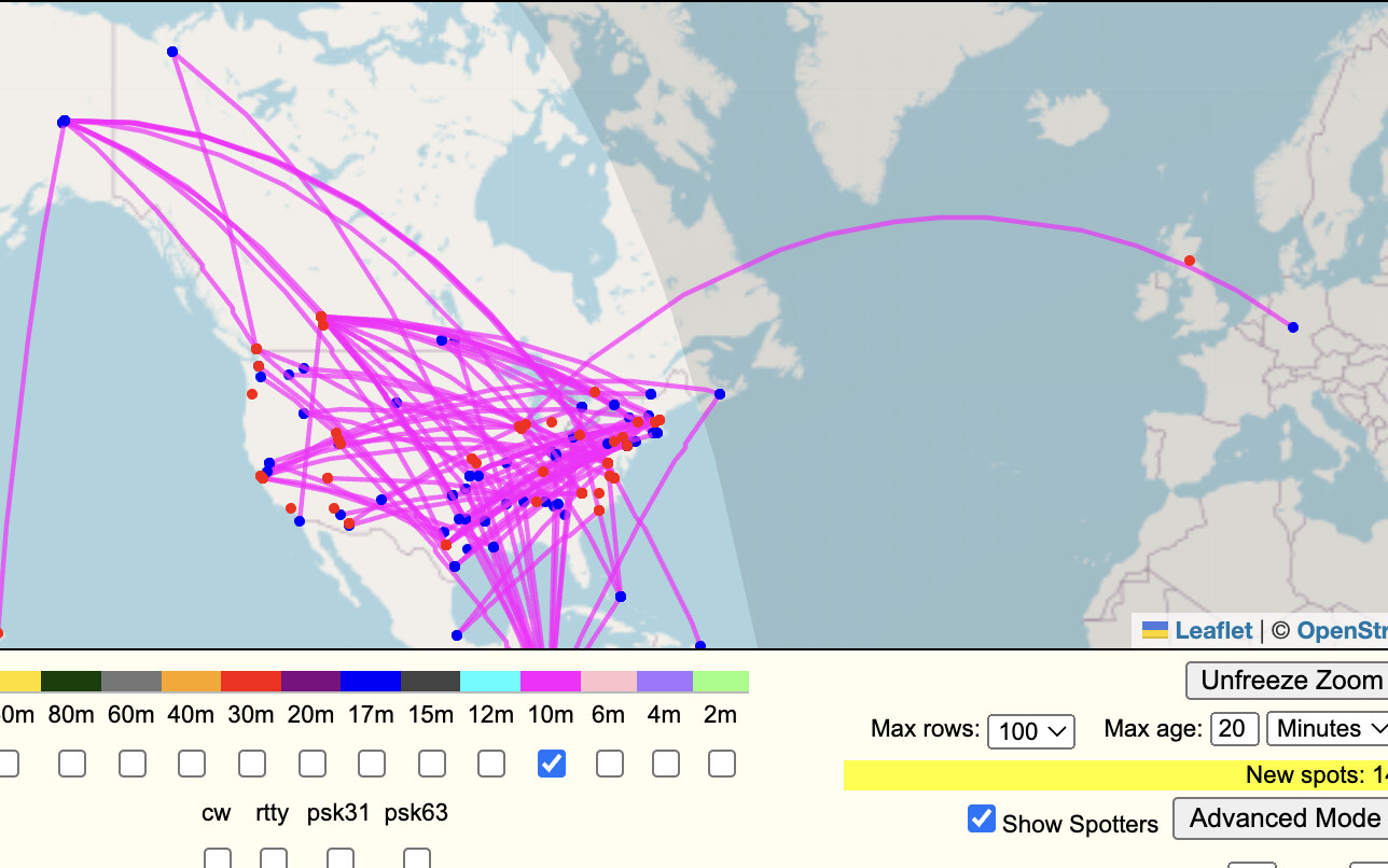

I’m trying to test the Reverse Beacon Network (RBN) in my backyard. Have my antenna set up on the mast, off the ground, and the KX2 operating @ 10W on 14.032MHz. I programmed in the following CW: “CQ CQ CQ DE AL5KA AL5KA AL5KA” and have it repeat that message every 4 seconds @ 15WPM.
I’m looking at the RBN here: RBN - Reverse Beacon Network
Watching for my callsign to appear in the ‘spotted’ column or on the map. Nothing. Tried both night and day.
Is there something I can do better? Or is it just that my weak signal + distance from beacons means I’m going unheard? When I check the “show spotters” box on the RBN I would assume that shows me all of the possible beacons on the map. The nearest ones I see are all the way in southern BC, Canada
That should work. I just listened and heard a VE3 station having a QSO with someone on 14.032, and he was pretty loud. You might try calling CQ on 14.060, which is the QRP area on 20 CW.
Also, if you don’t get any hits on 20 then try 17, 15, or 10.
P.S. if you are trying it at night then also try 40. At night 40 goes long and I’ve had QSOs with people around the world.
Looks like 10 is working right now, so you might give it a shot. If you check the band boxes it will show you some useful data… here is with just 10 checked:

Thanks. I used the webSDR in Anchorage and heard myself on 10, 20, & 40m. At the same time I had the RBN page up and didn’t see myself at all. On the RBN 10m seemed to be doing quite well at the time and there was a station near me that was spotted. I guess my set up isn’t strong enough to reach the RBN. Maybe it would be if set up on a peak, I guess I’ll have to try that sometime. At least I know I am transmitting as the SDR heard me
I see an RBN hit for you. 18 mins ago, you were picked up by VE6JY on 14.060.
Very likely I could chase you on 20 right now, and probably other bands too. 17 is hot Today.
Oh I see that now but only when I type “AL5KA” into the spotted search bar. I guess I missed it? I was watching the map and doing “ctrl+f” to search for AL5KA on the page
