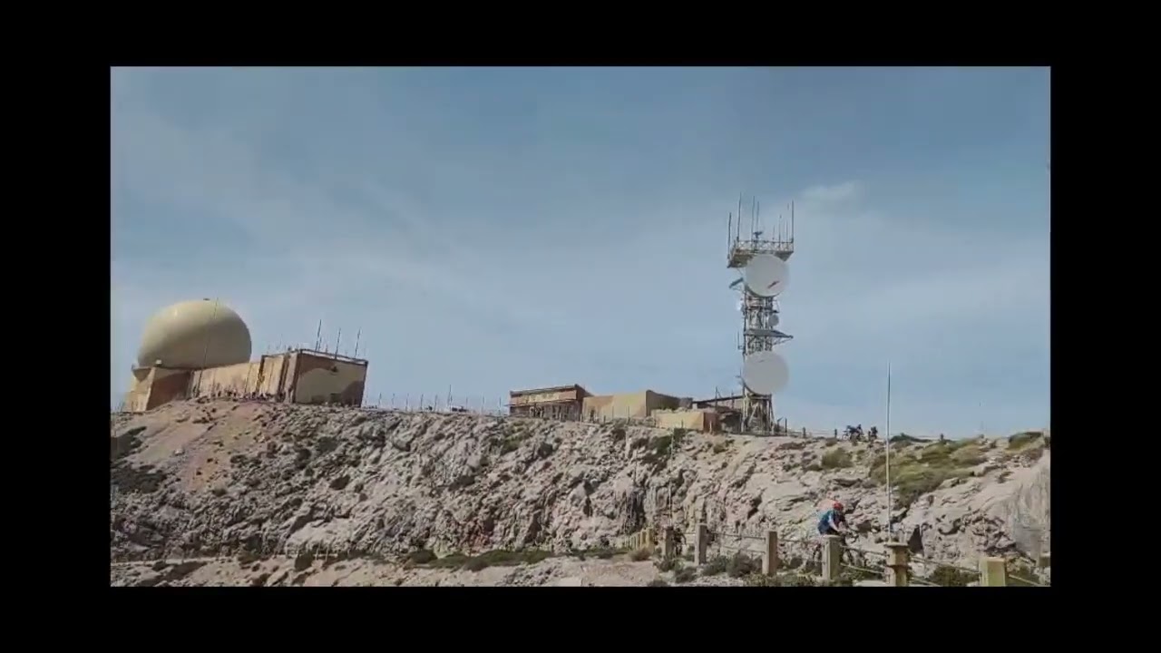

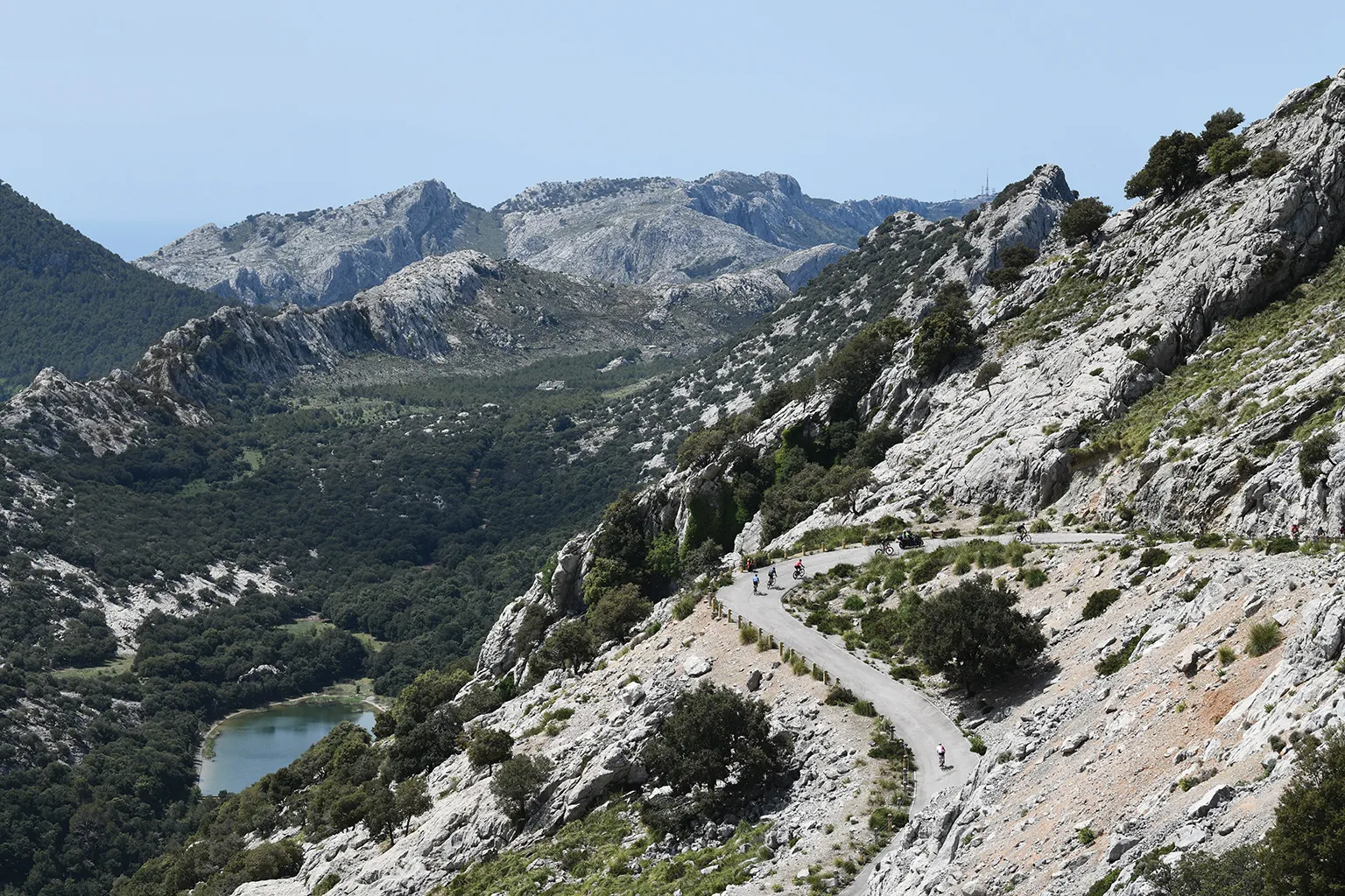

Visual perspective is of course tricky on a frankly awful handheld video… but it looks like some of these cyclists seen in the video have got above the final hairpin. Looking at the map that surely puts them inside the AZ?
I don’t know where the locked gate is on a normal day, but maybe there is a cycling “hill climb” event that get access to the true summit?
Edit:
Found this…. looks like there is a way up the road which seems to have only become available in the last few years. I’m guessing the video above was taken on a recent running of this event. Whether you do it by bike, or maybe you piggy back on the event somehow, it does seem there is a chink of light for activation?
Edit2: Unconfirmed date for 2026 running is 28th April.
